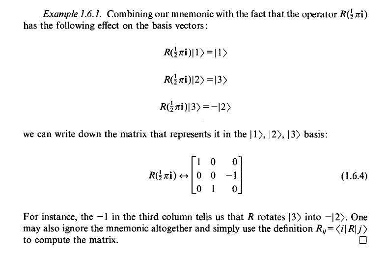

In Shankar it is given like this:
But I'm having trouble verifying it mathematically as given in the question.
