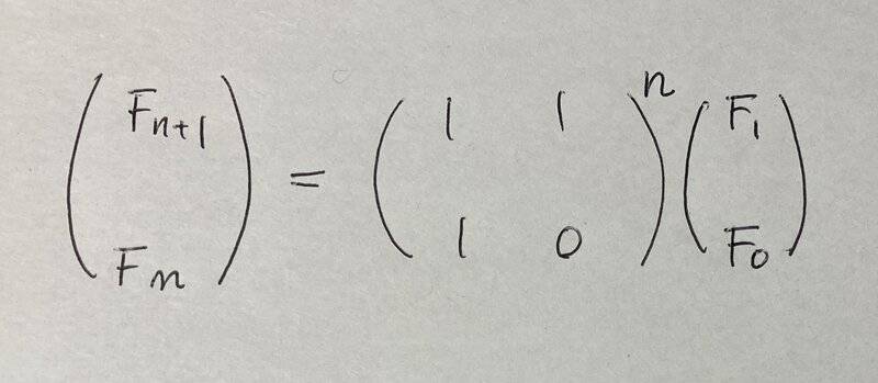

Though same as post #2,
Likes martinbn and murshid_islam
