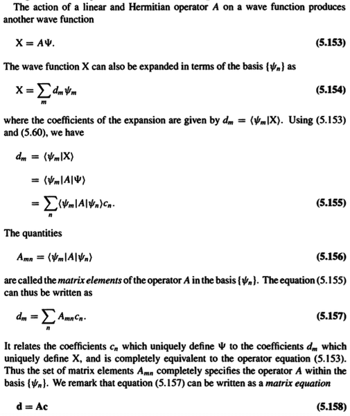

The extract from a textbook below only talks about the matrix representation of a Hermitian operator. But is it true that all linear operators can be represented by matrices, not just those that are Hermitian?
Yes. The matrix element given in formula 5.156 is just as meaningful for non-Hermitian operators. It will just be (in most cases) a non-Hermitian matrix.
