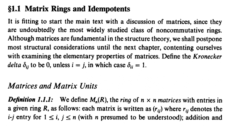

I am reading Louis Rowen's book, "Ring Theory" (Student Edition) ...
I have a problem interpreting Rowen's notation in Section 1.1 Matrix Rings and Idempotents ...
The relevant section of Rowen's text reads as follows:

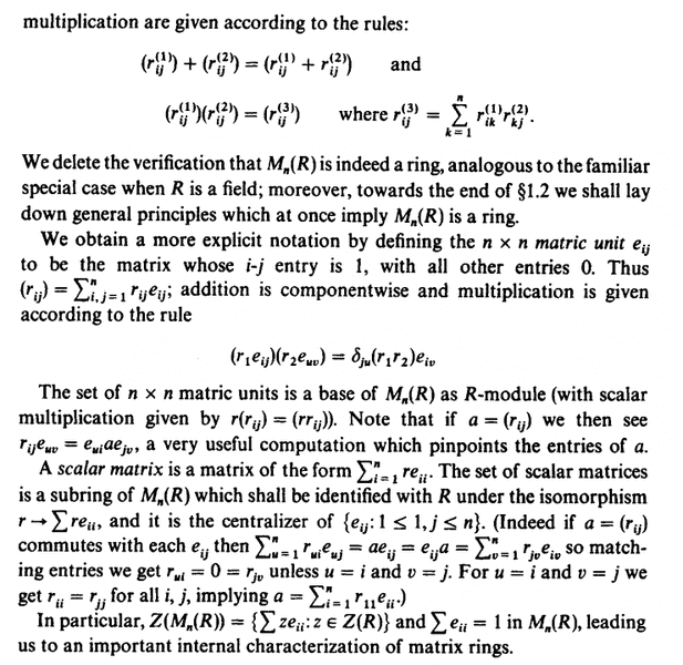

In the above text from Rowen, we read the following:
" ... ... We obtain a more explicit notation by defining the ##n \times n## matric unit ##e_{ij}## to be the matrix whose ##i-j## entry is ##1##, with all other entries ##0##.
Thus ##( r_{ij} ) = \sum_{i,j =1}^n r_{ij} e_{ij}## ; addition is componentwise and multiplication is given according to the rule
##( r_1 e_{ij} ) ( r_2 e_{uv} ) = \delta_{ju} (r_1 r_2) e_{iv}##
I am having trouble understanding the rule ##( r_1 e_{ij} ) ( r_2 e_{uv} ) = \delta_{ju} (r_1 r_2) e_{iv}## ... ...
What are ##r_1## and ##r_2## ... where exactly do they come from ...
Can someone please explain the rule to me ...?

In this case, ##r_1## and ##r_2## are simply two arbitrary scalars, i.e. elements of ##R##.
I wished you would have chosen an example with more zeros ...
So here we go:
##P = 1 \cdot e_{11}+ 3 \cdot e_{12} + 5 \cdot e_{21} + 4 \cdot e_{22}## and ##Q = 2 \cdot e_{11}+ 1 \cdot e_{12} + 3 \cdot e_{21} + 3 \cdot e_{22}## or
$$P= 1 \cdot \begin{pmatrix} 1 & 0 \\0 & 0 \end{pmatrix}+3 \cdot \begin{pmatrix} 0 & 1 \\ 0 & 0 \end{pmatrix} +5 \cdot \begin{pmatrix} 0 & 0 \\ 1 & 0 \end{pmatrix} + 4 \cdot \begin{pmatrix} 0 & 0 \\ 0 & 1 \end{pmatrix}$$
and
$$Q= 2 \cdot \begin{pmatrix} 1 & 0 \\0 & 0 \end{pmatrix}+1 \cdot \begin{pmatrix} 0 & 1 \\ 0 & 0 \end{pmatrix} +3 \cdot \begin{pmatrix} 0 & 0 \\ 1 & 0 \end{pmatrix} + 3 \cdot \begin{pmatrix} 0 & 0 \\ 0 & 1 \end{pmatrix}$$
And because matrix multiplication is row times column ##e_{ij} \cdot e_{kl} = \delta_{jk} \cdot e_{il}##.
The scalars ##r_1,r_2## or ##\{1,3,5,4\}## and ##\{2,1,3,3\}## in your cases may stand anywhere, usually left to the basis, as they are the coefficients of the matrices ##P,Q## regarded as elements of the ##\mathbb{Z}-##module ##\mathbb{M}_2(\mathbb{Z})## with the basis ## \{e_{ij}\}##. If you take a field instead of the integers, you get a vector space, which of course is still a ring and therefore an algebra.

Thanks for the help, fresh_42 ... BUT ...
You write:
"... ... In this case, ##r_1## and ##r_2## are simply two arbitrary scalars, i.e. elements of ##R##. ... ...But the formula ##( r_1 e_{ij} ) ( r_2 e_{uv} ) = \delta_{ju} (r_1 r_2) e_{iv}##"is supposed to represent the multiplication of two matrices and ##( r_1 e_{ij} )## does not seem to represent an arbitrary matrix ... ... ?
Note that regarding this problem I received some help from on the Math Help Boards ...
Evgeny writes:
" ... ... Evgeny.Makarov ... ... ##r_1## and ##r_2## are numbers, or, more precisely, elements of the ring ##R##. They are also coefficients, or coordinates, of a matrix in the basis consisting of ##e_{ij}##. If one matrix is ##\displaystyle\sum_{i,j=1}^nr^{(1)}_{ij}e_{ij}## and another is ##\displaystyle\sum_{i,j=1}^nr^{(2)}_{ij}e_{ij}##, then when you multiply them, you apply distributivity and get ##\displaystyle\sum_{i,j,u,v=1}^nr^{(1)}_{ij}e_{ij}r^{(2)}_{uv}e_{uv}##, and the formula in your quote says how to compute ##r^{(1)}_{ij}e_{ij}r^{(2)}_{uv}e_{uv}##. ... ... "
Does Evgeny's post look right to you ... ?
Peter

Math Amateur said:
" ... ... Evgeny.Makarov ... ... ##r_1## and ##r_2## are numbers, or, more precisely, elements of the ring ##R##. They are also coefficients, or coordinates, of a matrix in the basis consisting of ##e_{ij}##. If one matrix is ##\sum_{i,j=1}^nr^{(1)}_{ij}e_{ij}## and another is ##\sum_{i,j=1}^nr^{(2)}_{ij}e_{ij}##, then when you multiply them, you apply distributivity and get ##\sum_{i,j,u,v=1}^nr^{(1)}_{ij}e_{ij}r^{(2)}_{uv}e_{uv}##, and the formula in your quote says how to compute ##r^{(1)}_{ij}e_{ij}r^{(2)}_{uv}e_{uv}##.
Yes, it is right. The different naming of ##r_1## and ##r_2## refers to different views of the same thing.
##R## is the set, where our matrix entries come from. You might call them numbers, which I avoided, because it doesn't have to be numbers in the usual sense. It could be any ring, e.g. polynomials which usually are not called numbers. Since ##\mathbb{M}_n(R)## forms an ##R-## algebra, I had chosen the word scalar. In the end, they are simply ring elements of ##R##.
And because ##R## is not necessarily a field and ##\mathbb{M}_n(R)## therefore not necessarily a vector space, but only a finitely generated ##R-##module, I avoided the word coordinate, too. But the difference is marginal in this context. One might say coefficients as well, as the ##e_{ij}## are the generators of ##M=\mathbb{M}_n(R)## and the ##r^{(1)}_{ij}\; , \;r^{(2)}_{ij} \in R## coefficients at the ##e_{ij}##. In the case of ##R## being a field, we call the ##\{e_{ij}\}## a vector basis, ##\mathbb{M}_n(R)## a vector space (or an algebra) and their coefficients coordinates.
The difference between a vector space and an algebra is, that an algebra ##\mathcal{A}## doesn't need to have a field as scalar set ##R## and even more important, that it has two multiplications: a scalar multiplication ##R \,\cdot\,\mathcal{A}## like vector spaces and modules plus a inner multiplication ##\mathcal{A}\,\cdot\,\mathcal{A}## like rings.
Edit: Btw, coefficient literally means "number at".
