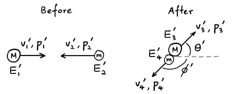

My attempt to the first question:
In laboratory frame ##S##:
In a zero-momentum frame ##S'## moving with velocity ##v## relative to ##S##:
Components of ##p_3'## are:
$$ p_{3x}'=p_3'\cos\theta' \tag{1} $$
$$ p_{3y}'=p_3'\sin\theta' \tag{2} $$
By Lorentz transformations for energy and momentum,
$$ p_{3x}=\gamma(v)(p_{3x}'+vE_3'/c^2) \tag{3} $$
$$ p_{3y}=p_{3y}' \tag{4} $$

So the angle of deflection of mass $M$ is given by
$$ \tan\theta=\frac{p_{3y}}{p_{3x}}=\frac{\sin\theta'}{\gamma(v)(\cos\theta'+v/v_3')} \tag{10} $$
If we can resolve ##\gamma(v)## and ##v_3'##, then we can take the derivative of ##\tan\theta## with respect to ##\theta'## and obtain its maximum value.

(2) How to obtain ##v_3'##? Apply energy-momentum relationship on mass ##M## in ##S'## after collision:
$$ (E_3')^2-(Mc^2)^2=(cp_3')^2 \tag{17} $$
Now we have equation (7) and (17) for the three variables ##E_3'##, ##p_3'## and ##v_3'##. We need one more relationship to solve for ##v_3'##.
Besides, it will take too much effort to solve the above equations. I guess there should be a simpler approach. Do you have any idea?
