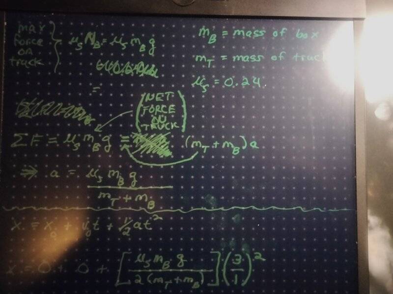

A box rests on the (horizontal) back of a truck. The coefficient of static friction between the box and the surface on which it rests is 0.24. What maximum distance can the truck travel (starting from rest and moving horizontally with constant acceleration) in 3.0 s without having the box slide?
F = m*a
x = x_0 + v_0*t + (1/2)*a*t^2
The equation at the bottom is me attempting to solve for the distance. Without knowing the mass of the box and truck my approach to this problem isn't possible?
Draw a FBD of the box, then examine Newtons Second Law for it.
Likes I_Try_Math and Delta2
Hint 1: Just focus on the box, the truck is part of the problem but is not the "core" part of the solution...
The no slide condition means that the acceleration of the truck must be always the same as the acceleration of the box.
Hint 2: Forget the no slide condition momentarily and think: what is the maximum acceleration that the box can have? beware not maximum velocity but maximum acceleration.
Likes I_Try_Math
I was able to find the answer (~10.6 meters) with your hints, thank you 👍
