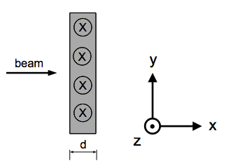

A beam of electrons is fired into a rectangular region of space that contains a uniform magnetic field in the -z direction. The electrons are moving in the +x direction, as shown. The speed of the electrons in the beam is 6.00 × 106 m/s. The mass of an electron is me = 9.11 × 10−31 kg. The magnitude of the magnetic field in the rectangular region of space is 1.50 × 10−2 T. The rectangular region has a width d.
What is the maximum value of d for which the electron beam will make it through to the other side of this rectangular region, and continue on to the right of the region?

Ok the problem I am having is relating distance to any equation I have. In previous problems I have worked, none of them had distance as part of the problem. If someone could just give me a hint or something about how to relate distance to the problem, that would be much appreciated.
Magnetic fields make moving charged particles move in circles. If the radius of the circle is too small, the electrons will remain in the region.
The relevant equations are F=qvB and a=v2/r, and of course, F=ma
I attached a picture to go along with my problem, did you happen to look at it? I am not sure if I attached it right.
The picture clarified it a bit, but nothing has changed.
The electrons will follow a circle with radius r. If r is smaller than d, then the electrons will turn around and come back the way they came.
