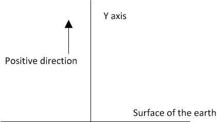

This is so important that I dedicate a fancy drawing ;-) to celebrate this first crucial step:
(If I weren't so old, I would know how to include the picture reasonable size here instead of as an attachment. Never mind, someone will give me a tip and we don't want to get distracted now).
As you can see, I have only drawn one half of the y axis, the positive half. As soon as we calculate a negative y somewhere, we have to check, double check and check again. It's not completely impossible (wells, for instance), but usually things travel differently above ground than below.
All we need to do now to really get going is designate a unit vector in the positive y-direction. Something that is 1 long and points upward. In view of the wording in the OP, I propose a 1 meter long nice fat arrow standing up at the origin (the surface of the earth).
From now on y is a vector with the dimension of length and a magnitude expressed in meters. Convention: y fat is vector, y normal is magnitude.
Same coordinate system for velocity vy = change in y per unit time. Since we're talking linear motion (one dimension in space, but that confuses the term dimension in physics), the y subscript is nice but not essential. Different beast: v lives in the same coordinate system but has a different (physical) dimension, namely m/s in our case. I'm not allowed to shout in PF, but you can NOT add things that live in different (physical) dimensions. So when you end up adding y to v you have either forgotten a factor time somewhere or you're working so sloppily that you deserve to flunk. All in good spirit.(I lost the rest of this post - quite a bit) so now I first post this and then continue at leisure with the remainder.

Back to the problem. In our (my) new coordinate system the proper equation is V(t) = V(o) + at. Vectors with the same dimension (m/s). At a certain point you want to do some calculation with numbers. Magnitudes of vectors are non-negative numbers. But it's always good to hang on to dimensions. Somewhat double. So the number variety is V(t) = V(o) + at. Provided you take the direction into account. In our system V is up and decreases because the Earth is pulling down. Two ways to do this:
preferred way: write V(t) = V(o) - g t with g = 9.81 m/s2
equally correct but more confusing/error prone: V(t) = V(o) + g t with g = -9.81 m/s2. Potential confusion: because non-bold suggests magnitude and that can't be negative.
Both are correct. So is the other (stubborn, confusing, error prone, unconventional) choice to let the positive y-axis point downwards. Even there v and g point in opposite directions. Never mind.
