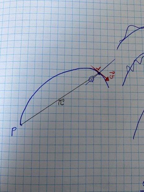

A projectile thrown from a point P moves in such a way
that its distance from P is always increasing. Find the maximum angle
above the horizontal with which the projectile could have been thrown.
Ignore air resistance.
projectile motion
Can I get a hint on how to start with this problem ? Thanks in advance
I can't really think of anything...
If there exists a point Q on the parabola where the distance from the launch point P is just about to start decreasing with time, the trajectory is orthogonal to the vector ##\overrightarrow{PQ}##, yes? Which would make sense, because at this point the velocity has no radial component.
(To see this another way, if ##d(r^2)/dt = d(x^2 + y^2)/dt = 2x \dot{x} + 2y\dot{y} = 0## at this point, then ##dy/dx = - x/y##, i.e. the gradient is orthogonal to that of the radius vector).
Does that help?
Likes simphys and PeroK

If you throw the object straight up, then it gets further away for a while, but then falls back towards you. That's no use.
If you throw the object almost along the ground, then it keeps getting further and never gets closer.
There must be some maximum angle in between the two where the object is always getting further away.
Use calculus to find it!

owh goshhh! Thanks a lot guys. So I kept looking at it but didn't really get why using that distance r^2 until it hit me that it's the distance/(magnitude of the position vector) that need not to become negative i.e. derivate >= 0... and not one of the components or something like that. I was trying to get some relation going via the components to find that angle lol.
One question though. Can you please (@ergospherical) explain that sentence where you said that the trajectory is orthogonal to the vector a bit more please? Why is that? I will show you what I think you mean but I don't get why that's the case.
Thanks a lot oncde again

I don't want to put you off, but this problem might be a little bit advanced. There is a direct approach, which is just to crunch the calculus. The other approach involves first finding an equation for the parabola ##y(x)## by eliminating ##t##. If you haven't seen that already.

Do you recall the "SUVAT" equations of constant acceleration? Can you write the velocity and position as functions of time, i.e. ##\mathbf{v}(t) = (v_x(t), v_y(t))## and ##\mathbf{r}(t) = (x(t),y(t))##. Once you have accomplished this you can put ##\mathbf{r} \cdot \mathbf{v} = 0## and employ what you know about the discriminants of quadratic equations (so as to enforce that there are no solutions...).

hoooww that is so amazing! didn't think about the scalar product at all...
But @ergospherical can you please explain why we know that'd the be the case? that the vector is orthogonal to the trajectory?
Edit: Thank you, I indeed found the relation with answer 70.5 degrees. appreciate it a lot!

So If I'd look at it in terms of the fact that the derivate of the distance can become zero as perok pointed that's easy
But for this method, how we actually know that v and position are orthogonal is a question for me at this point

There's a few ways to look at it. The rate of change of distance is the radial component of the velocity; if ##\mathbf{v}## is orthogonal to ##\mathbf{r}##, then ##\mathbf{v}## has no radial component.
You could also think in terms of calculus;\begin{align*}
\dfrac{d(r^2)}{dt} = \frac{d}{dt} (\mathbf{r} \cdot \mathbf{r}) = 2\mathbf{r} \cdot \mathbf{v}
\end{align*}so turning points of ##r^2## (and hence ##r##) correspond to when ##\mathbf{r} \cdot \mathbf{v} = 0##.
