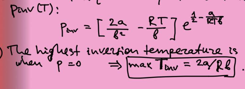

I’m trying to calculate the maximum inversion temperature from the inversion curve.
See below
The notes my lecturer has provided state that the maximum temperature can be found taking p = 0 in the inversion curve formula, given as:
I’m not sure how to obtain this??

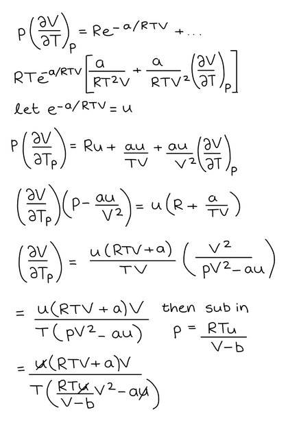

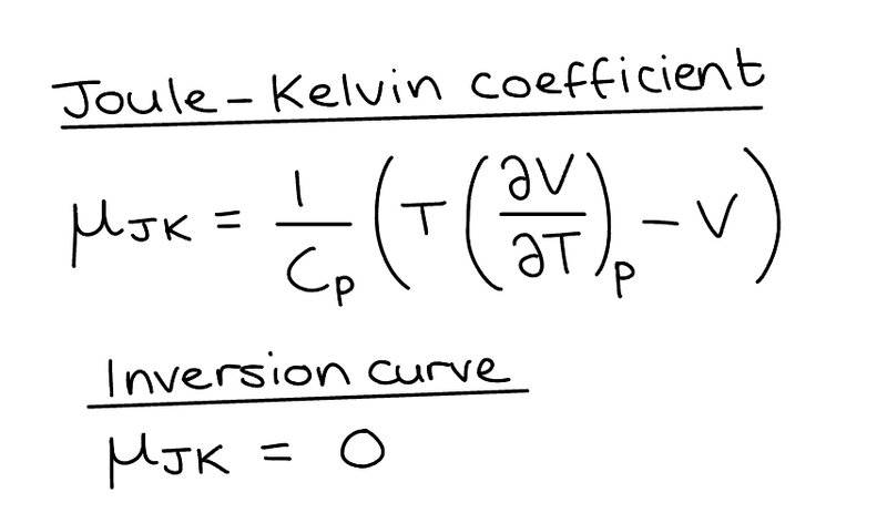

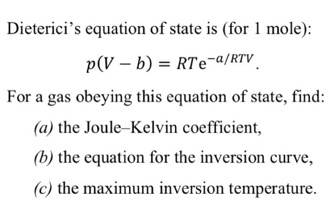

These are the formulas:

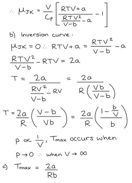

This is my attempt at a solution :
Not sure if this approach is right?
Your work looks correct to me.
For part (b) you obtain the inversion curve as a relation between the inversion temperature ##T## and the molar volume ##V##:
I believe an inversion curve is typically a relation between ##T## and ##P## rather than between ##T## and ##V##.
Hey. Thanks for the response. Do you have any idea how I would go about obtaining the expression my lecturer has provided? Namely, $$ P_{inv} = \left[\frac{2a}{b^2} - \frac{RT}{b}\right]e^{\frac{1}{2}-\frac{a}{RTb}}$$ If I am to rewrite ## T = \frac{2a}{R}\left(\frac{1-\frac{b}{V}}{b}\right) ## in terms of ##P## do I not need an explicit expression for T or V from Dieterici’s e.o.s.
You need to eliminate ##V## between the equation of state and the equation ## T = \frac{2a}{R}\left(\frac{1-\frac{b}{V}}{b}\right) ##. Decide which equation is easier to solve for ##V## and then substitute for ##V## in the other equation.
Ahhh okay, thank you. For some reason it didn’t click that I could solve for V using ## T = \frac{2a}{R}\left(\frac{1-\frac{b}{V}}{b}\right) ## and then sub that into the other equation 😬 I’ve got it now
