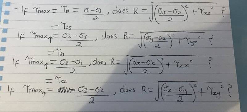

Hi, there's no particular question I need help on - just a few things I need clarifying. To determine the max shear stress, I know max shear stress = (max normal stress - min normal stress)/2, but are these equations true for a 3D stress state? (please look at attached image)
Thank you
Thank you
Do you mean the difference between the maximum and minimum normal stress, or the difference between the maximum and minimum principal stress?
The equation to determine max shear stress is: (max principle stress - min principle stress)/2
OK. Do you know how to determine the shear stress and normal stress on a plane of arbitrary orientation, given the magnitudes of the three principal stresses and assuming that they are aligned with the x, y, and z Cartesian coordinate directions?
