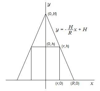

Here is the question:
A cylinder is inscribed in a right circular cone of height 6 and base radius equal to 4.5. What are the dimens?
A cylinder is inscribed in a right circular cone of height 6 and base radius equal to 4.5. What are the dimensions of such a cylinder which has maximum volume?

Let's work this problem in general terms so that we then derive a formula into which we can plug the given data.
First, let's draw a diagram of a cross-section through the axes of symmetry for the cone and cylinder. We will orient our coordinate axes such that the origin as at the center of the circular base of the cone. The radius and height of the cone are $R$ and $H$ respectively, while the radius and height of the cylinder are $r$ and $h$ respectively. Since these parameters and variables represent linear measures, we assume they are non-negative. Both measures of the cone must be positive.
Now, our objective function, that function that we wish to optimize, is the volume $V$ of the cylinder:
$$V(h,r)=\pi hr^2$$
As we can see, the point $(h,r)$ is constrained to lie along the line:
$$y=-\frac{H}{R}x+H$$
and thus, our constraint may be given as:
$$g(h,r)=\frac{H}{R}r-H+h=0$$

Thus the critical value $r=\frac{2}{3}R$ is at a maximum. This is the critical value in which we are interested. Thus the dimensions of the cone which maximize its volume are:
$$r=\frac{2}{3}R$$
$$h=\frac{H\left(R-\frac{2}{3}R \right))}{R}=\frac{1}{3}H$$

Now we may plug in our given data:
$$H=6,\,R=\frac{9}{2}$$
to obtain for this problem:
$$r=\frac{2}{3}\cdot\frac{9}{2}=3$$
$$h=\frac{1}{3}\cdot6=2$$
Thus, we have found that the dimensions of the cylinder inscribed within the given cone having maximum volume are a radius of 3 units and a height of 2 units.
