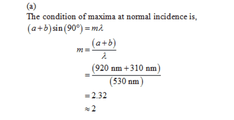

A diffraction grating is made up of slits of width 300 nm with separation 900 nm. The grating is illuminated by monochromatic plane waves of wavelength l 600 nm at normal incidence. How many maxima are there in the full diffraction pattern?
mλ = dsinθ
I thought that I could just use the above equation and doing so I get m = 1.5. However, the solution uses
(a+b)sinθ = mλ . Can I really just add the slit width and the separation width like that?

You need the distance between the centers of adjacent slits, if 900 nm is the space between their edges you have to add the slit width.
Oh that makes sense! Thank you!
