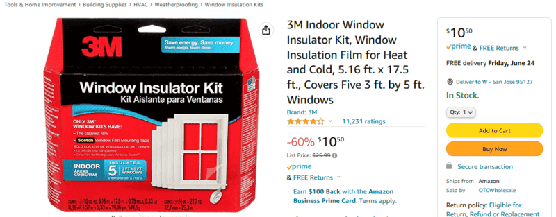

One way to cut down on heat loss through single-pane windows is to add clear window film:
https://www.amazon.com/dp/B00002NCJI/?tag=pfamazon01-20
I don't know if that is easily available there in Italy where you are, but it's worth looking into.
