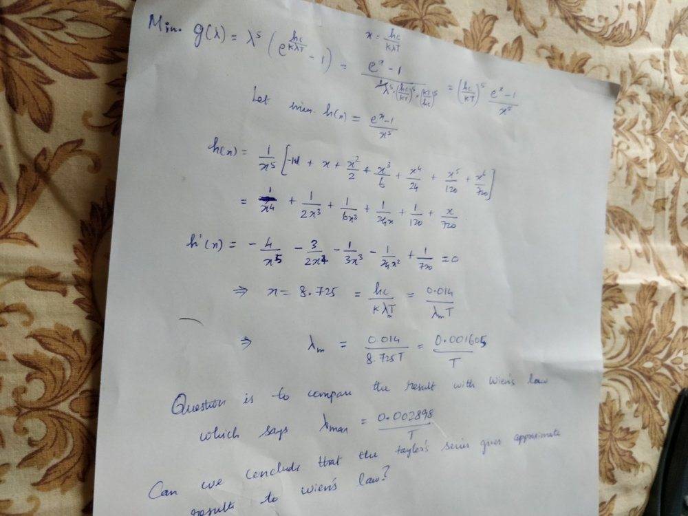

Hi
Can anyone provide the complete solution to this problem only using Taylor's series?? Please.
kar32009 said:
Hi
Please so us your efforts on this so far.
Are you saying that there was something wrong with what was done previously in this thread?
Not at all. Question is to compare the results with what we get with Taylor's series. So is it enough to conclude that Taylor's series gives only an approximate result to Wien's law?
Sure. That's what was found.
Cool. With 7, 8 and 9 terms expansion in Taylor's series, I found the maximum wavelength to be .001605/T, .002247/T and .002546/T respectively. So as the terms increase, it approaches to Wien's law.
