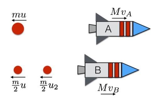

I stumbled upon a 3-year old article from Wired that poses this question on rockets:
Suppose I have two rockets with a mass M and fuel mass m. Rocket A shoots all the fuel at once (again, like a nuclear propulsion engine) with a fuel speed of u and rocket B shoots two blobs of fuel—first a shot of m/2 and another one of m/2. Both start from rest. Which rocket has the higher final velocity?
Assumptions:
  • When fuel is expelled from a rocket, it leaves with a constant velocity that is relative to the rocket. I will call this the exhaust velocity and use the symbol u.
  • Momentum is conserved when stuff is shot out the back of the rocket (I already said this).
  • As fuel is consumed, the total mass of the rocket decreases. In fact, it might be easier to separate the mass into two parts: the mass of the fuel (mf) and the mass of the payload (M). Here, “payload” mass includes everything that is not fuel (rocket parts, humans, robots, computers, iPhones).
link to full article: https://www.wired.com/2015/10/whatd-make-better-rocket-nuclear-ion-engines/
The author claims that rocket A will have the higher velocity, but if I actually write out all the momenta, it seems to me that rocket B should be faster. I believe the author's error is that the velocity of the fuel shot from rocket A should be [itex]v_A - u[/itex] not [itex]u[/itex], since [itex]u[/itex] is the fuel speed relative to the rocket. Am I correct in thinking that the author is mistaken, or am I missing something?

The final velocity of the rocket will be proportional to the average final velocity of the fuel.
In both cases, half the fuel will be traveling at u.
In case A, the other half will also be traveling at u, but for B, it will be traveling slower (assuming it was also discharged at a velocity u relative to the spacecraft ).
So A has to be faster.
Calculate the total momentum of the left-moving mass. By momentum conservation, that will be the final momentum of the right-moving rocket. Which is greater? It will be more clear what is going on if you imagine the first case as the simultaneous expulsion of ##m_1## and ##m_2##; both end up moving to the left at speed ##u## in the first case. But in the second case, how does the speed of ##m_2## compare with the speed of ##m_1##?
At a more handwaving level... in the second case, some of the momentum gained from expelling the first mass is "wasted" accelerating the second mass to the right.
gumby said:
Hold on. The fuel speed is u relative to the rocket.
Yes, but it is relative to the speed of the rocket at the instant before the fuel is ejected, not the instant after.
Otherwise ##u## wouldn't be a constant, it would depend on the mass of the rocket plus the remaining fuel onboard.
I guess that's the point of my confusion then: why is [itex]u[/itex] relative to the rocket's velocity before the fuel is ejected? It's been quite some time since I studied physics, so I very well could be wrong, but my intuition tells me it should be relative to the velocity after the fuel is ejected. My reasoning is this:
Suppose there is some amount of energy [itex]E[/itex] stored in the rocket that will be completely converted into kinetic energy after ignition. Then we have [itex]E = \frac{1}{2} mv_{fuel}^2 + \frac{1}{2} Mv_{rocket}^2[/itex] (velocities relative to a stationary observer). If the rocket is massive enough such that the rocket's final velocity is essentially 0, then we will in fact have [itex]v_{fuel}=-u[/itex]. However if the rocket is light enough such that the rocket achieves non-negligible velocity, then the speed of the fuel will be less than [itex]u[/itex], so [itex]u[/itex] cannot be the speed relative to the initial rocket speed.
Or as a thought experiment, suppose I have a gun with a muzzle velocity of 1,000 m/s. If fire the gun while it's firmly attached to the ground (no recoil), the bullet's velocity will be 1,000 m/s relative to both the ground and the barrel. However if I fire the gun while standing on ice such that the recoil moves me backwards, I believe bullet's velocity should be 1,000 m/s relative to the barrel, and less than 1,000 m/s relative to the ice.
Does this make sense?
That is a reasonable simplifying assumption. It amounts to assuming that the kinetic energy provided by the cartridge is identical in either case.
If one makes this assumption then it is clear that firing two notional bullets using one notional double-charge of powder is more efficient than firing two notional bullets in sequence one after the other. In either case, one has two bullets flying away and carrying momentum determined by their combined mass and the motion of their combined center of mass. But in the one case those two bullets are also carrying excess kinetic energy due to their relative motion. This leaves a tiny bit less kinetic energy available for the recoil of the gun.
As long as the rocket equation [1] is a valid model for the situation both burn profiles should yield the same total change of speed (delta-V). This can both be seen from the rocket equation or from conservation of momentum.
However, if the rocket is in a gravity field then the Oberth effect [2] comes into play. Here most of the delta-V from an impulsive burn will go into changing the rockets orbital energy if the maneuver is performed at periapsis. In this case your situation A will give more orbital energy than B if the second burn in B is done away from periapsis.
