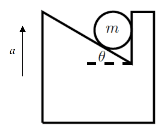

A mass $$m=12 kg$$ is placed on a cube, as shown in the attached figure. The cube is made of a breakable material, that breaks when a force larger than $$F_{max}=150N$$ is exerted on it.
Someone pulls the cube upwards with an acceleration of $$a \, \frac{meter}{sec^2}$$. What is the maximal acceleration possible for which the cube edges will not break? ($$\theta = \frac{\pi}{6} $$)
Newton's laws,
g=9.8 m/s^2
Using Newton's second law,
cos\left( \frac{\pi}{6} \right) m(a+g) = 150 \Leftrightarrow a = \frac{\frac{2\times 150 }{\sqrt{3}}-mg}{m} =4.633.
Unfortunately, the possible answers are
A. 1.025, B. 0.625, C. 3.75, D. 2.75, E. 1.75, F. 0.
What am I getting wrong? Isn't the force exerted on the inclined part of the cube equal to $cos\left( \frac{\pi}{6} \right) m(a+g) $?

What is supposed to break first is the edge to the right of the mass. At the dashed line (the problem statement says it's a point mass ?! ).
If ##\theta=0## the mass doesn't lean into that edge

Are you sure? It doesn't actually say that, and assuming it I get 11.85, nowhere near any of the options.
@Combinatorics , the title says "breakable edge", but the problem statement does not mention edge. Have you quoted the problem statement exactly?
Maybe the cube is hollow, in which case there are three normal forces on it to consider. The only one which seems to match an option is the sloped surface.

How do you get ##\cos(\theta) m(a+g)## for the normal force on the sloped surface? Which direction did you consider for the balance of forces?

##cos\left( \frac{\pi}{6} \right) m(a+g) = 150 ## is wrong.
The vertical forces on the ball are:
- the upwards component of the 150N force
- the downwards weight.
These produce the vertical acceleration.
[EDIT. If not clear, the 150N force is the normal reaction between ball and 'slope'. Also, the reaction force on the side of the ball is smaller, so does not determine the breaking-point (which is not hard to prove).]

I went over all the comments here, and understood that my force balance is wrong. Unfortunately, I have no idea where is my mistake exactly.
The way I obtained the equation ##\cos\left( \frac{\pi}{6} \right) m(a+g) = 150 ## is:
By calculating the forces acting on the sloped part of the cube, we have (from Newton's 2 law):
## N-mg \cos\left( \frac{\pi}{6} \right) = ma \cos\left( \frac{\pi}{6} \right) ##, so that ## N=mg \cos\left( \frac{\pi}{6} \right) + ma \cos\left( \frac{\pi}{6} \right) ##, and this should be less than or equal to ##150 N##. Will you help me understand what is exactly wrong here?

No, there are three forces acting on the cube, and since we are not given a mass, gravity is not one of them.
I think you mean from analysing the forces on the mass. They are gravity and two normal forces. All three have a component parallel to the slope.
I think you have mis-identified which force is 150N when the cube breaks,
Refer to the free-body diagram of the ball (which you should already have drawn!). You will see there are 3 forces acting on the ball:
1) it's weight, mg
2) the normal reaction, R₁, from the sloping contact surface of the cube
3) the normal reaction, R₂, from the vertical contact surface of the cube.
This means the 2 forces acting on the cube which could break it are the Newton 3rd law partners of R₁and R₂. These, of course, have the same magnitudes as R₁and R₂.
It is not hard to show |R₁|>|R₂|. This means the cube breaks if R₁>150N. So you need to find the acceleration which makes R₁=150N.
[EDIT: There is a 3rd force acting on the cube - the external force which accelerates the whole system upwards. I'm discounting this as a force which causes the breakage as I believe the intent of the question is to find R₁.]
If you are not clear how to proceed, see post #9 for a hint.

AS I read @Combinatorics' work, there is no disagreement over which normal force matters, only a miscalculation of its relationship to mg etc.
Agreed. I was wrong to say ‘mis-identified’. @Combinatorics has identified the correct force - the normal reaction on the sloping surface.
But ##m(a+g)## is the normal force exerted on a vertically accelerating horizontal surface (as in a simple elevator problem). ##\cos\left( \frac{\pi}{6} \right) m(a+g)## is its component 30º to the vertical.
In this problem, the surface is not horizontal, so the component of ##m(a+g)## is the wrong force. That’s the mistake.
Can I encourage @Combinatorics to draw a free-body diagram of the ball and apply Newton’s 2nd law?

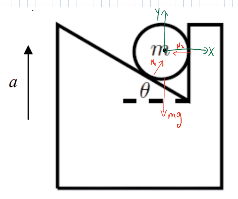

Hi,
Thank you! Here is my attempt:
I defined ##x## and ##y## axis as shown in the image. From this I have that
\sum F_x = N_1 \sin \theta - N_2
\sum F_y = N_1 \cos \theta - mg
Is this correct?

Yes. Good. What can you say about the magnitude of ##N_1##? If you apply 'F=ma' in the y-direction, you're almost home.

Amazing! So,
ma = N_1 \cos \theta - mg \Rightarrow a_{\text{max}} = \frac{ 150 \cos \theta - mg}{m} = 1.025
Which is indeed one of the answers!
Thank you very much! This was very helpful!
