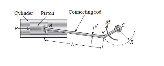

This really confused how is it that when Cosα is minimum P is maximum? shouldn't it be the oppose?
Problem statement (IGNORE):
The piston in an engine is attached to a
connecting rod AB, which in turn is connected to a crank arm
BC (see figure). The piston slides without friction in a cylinder
and is subjected to a force P (assumed to be constant) while
moving to the right in the figure. The connecting rod, which has
diameter d and length L, is attached at both ends by pins. The
crank arm rotates about the axle at C with the pin at B moving
in a circle of radius R. The axle at C, which is supported by
bearings, exerts a resisting moment M against the crank arm
SOLUTION (MANUAL):
The maximun allowable force P occurs when cos(α) has its
smallest value, which means that α has its largest value.

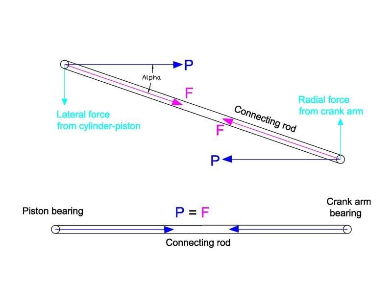

(just a thought, but...) When does the resisting moment M exert the most force on the connecting rod?
Likes Mohmmad Maaitah
There is also compression in the crank arm.
P does not have a maximum or minimum during operation; we are told it is constant. We are asked for the maximum allowable value of that constant. For that, we need to find the maximum compression in the rod for a given P.
If we take the piston to be massless and the compression in the rod is ##F##, what equation relates ##P, F## and ##\alpha##?
Could you explain your reasoning?
I think one can guess what @Mohmmad Maaitah 's reasoning is. If you take F as given, P is maximised when ##\cos(\alpha)## is maximised. But that is not the question.
