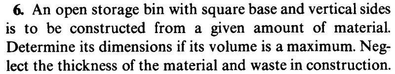

In summary: Homework Statement In summary, according to the book, b should be ##~\displaystyle \frac{1}{2}\sqrt{A/3}##.
Karol
1,380
First derivative=maxima/minima/vertical tangent/rising/falling
a are the sides of the base and b is the height
$$A=4ab+a^2,~~V=a^2b=a^2\frac{A-a^2}{4a}=...=\frac{1}{4}a(A-a^2)$$
$$V'=\frac{1}{4}(A-a^2-2a^2)=\frac{1}{4}(A-3a^2)$$
$$V'=0~\rightarrow~a=\sqrt{\frac{A}{3}},~b=\frac{\sqrt{3A}}{4}$$
According to the book b should be ##~\displaystyle \frac{1}{2}\sqrt{A/3}##

Your value for ##a## is correct. You need to show your work how you got ##b## for us to find your error.
Also, what does this problem have to do with the title of the thread?

It looks like your ##A##-equation is incorrect: you make the bin by cutting out four corner squares of sides ##b##, so those (wasted) squares are also part of the total material area ##A##. (The fact that the problem talks about wasted material suggests that you start with a square of area ##A## and then discard parts of it. Your modeled scenario would have no waste, because you would fabricate the material already in the shape of a square with missing corners.)
Anyway, I get a different solution from yours, because my area-equation is different from yours.

For what its worth: a much simpler approach is to wield ##GM \leq AM##.
i.e. if you want to maximize:
##x_1 x_2 ... x_n##
subject to ##\gamma_1 x_1 + \gamma_2 x_2 + ... + \gamma_n x_n = c##.
where each ##x_i \gt 0##, ##\gamma_j \gt 0## and ##c\gt 0## (here the constant ##c## is the 'given amount of material'), application of ##GM \leq AM## to your problem would tell you that, ##n= 3##, and
##x_1 = x_2##
(i.e. ##x_1## and ##x_2## are your ##a##)
and
##b = x_3 = \frac{1}{2} x_1##.
In general knowing a useful inequality can save you a lot of work and relations between arithmetic means and geometric means come up a lot. And wielding inequalities comes up quite a bit in calc / analysis.

$$A=a^2+4(b^2+ab)=(a+b)^2+2ab,~~V=a^2b$$
I can't extract a2 or b alone from A

The problem is quite easy if you use the Lagrange multiplier method. That saves you from having to solve a quadratic equation to get ##a## in terms of ##A## and ##b##, or ##b## in terms of ##A## and ##a##.
I don't see why you would interpret that the box was cut from a square. The OP's solution is correct right up to his last step. He made an error getting ##b## after he had ##a##. All that is needed is to correct that algebra, which he hasn't shown us. The book's answer is correct.
Likes ehild
The problem says "neglect waste in construction". @LCKurtz is right. The OP's solution is correct except the last step.
$$A=4ab+a^2~\rightarrow~b=\frac{A-a^2}{4a}$$
$$a=\sqrt{\frac{A}{3}}~\rightarrow~b=\frac{A-\frac{A}{3}}{4\sqrt{\frac{A}{3}}}$$
$$=\frac{2A}{12\sqrt{\frac{A}{3}}}=\frac{A}{6\sqrt{\frac{A}{3}}}=\frac{\sqrt{3A}}{6}$$
Right: I know that is what it says. My interpretation is just different from yours or Kurtz's or the OP's.
In past teaching I have assigned both versions of this problem, but in the scenario modeled by the OP I would just say "for a given area ##A## of sides and bottom, maximize the volume", with no mention at all of "waste".
So, are you happy with that answer? Do you know whether or not it is correct?
$$\frac{2A}{12\sqrt{\frac{A}{3}}}=\frac{A}{6\sqrt{\frac{A}{3}}}=\frac{\sqrt{3A}}{6}=\frac{\sqrt{3A}\sqrt{3}}{6\sqrt{3}}=\frac{1}{2}\sqrt{\frac{A}{3}}$$
I will take that as a "yes". :oldsmile:
