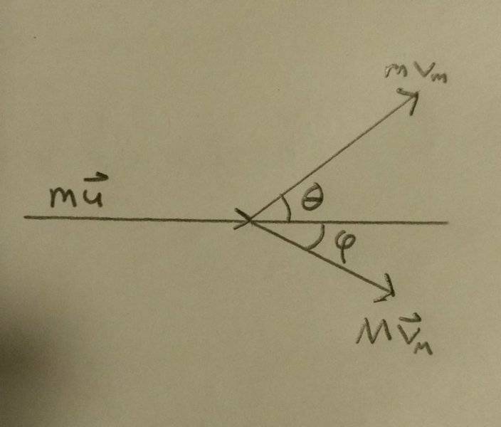

Show that the largest possible change in the kinetic energy , ##\Delta E_{kin}##, of a particle of mass ##m## running into another particle of mass ##M## at rest in the lab coordinate system is
[tex]\Delta E_{kin} = \frac{-4AE_{kin}}{(1+A)^{2}}[/tex], where ##A = \frac{M}{m}##.
Calculate the limit [tex]\lim_{M \to m} \Delta E_{kin}[/tex] and plot ##\Delta E_{kin}(A)##.
Conservation of energy.
Conservation of momentum.
Rutherford's experiment?

Alright, now we have the angles (which I'm not convinced by). Now what? Plugging them back into the energy expression isn't going to help me simplify it.
I feel like I've gone down a wrong path. Help, please?
How are you uncertain about your calculations so far?
You have gone to a lot of trouble to calculate some angles ... why? What do these angles mean?
Don't you need an expression for ##\Delta E_{kin}## in terms of ##E_{kin}##?

Looking at the photo that I posted, the angles themselves signify which directions the two particles move in after the collision; ##\theta## is the direction of ##m## and ##\varphi## the direction of ##M##. My uncertainty stems from the fact that I'm not sure I've made the right assumptions thus far. Because the question asked us to find the largest possible ##\Delta E_{kin}##, we want the numerator to be as large as possible and the denominator to be as small as possible. We can sort out the numerator easily enough:

Looking at momentum, you have ##m \vec{v} + M \vec{V} = m \vec{u}##.
From this, can you see that ##v## is minimised when ##\theta = 0##?
KE is minimised when ##v## is mininised.
So the particle ##m## would have to run into the other one head on, so that it comes to a halt?

In this case would ##(MV)^2 = (mv)^2 + (mv-MV)^2 - 2(mv)(MV)\cos(\theta + \varphi)##?
That's not right. Draw a vector diagram where ##m \vec{v} + M \vec{V} = m \vec{u}## and apply the law of cosines to that.

Alright.
If the picture I drew is correct:
[tex]
M^2 V^2 = (mu)^2 + (mv)^2 - 2(mu)(mv)cos(\theta)\\
\iff\\
V = \sqrt{ \frac{m^2 (u^2 + v^2 - 2uv\cos(\theta))}{M^2} } \stackrel{\frac{M}{m} = A}{=} \sqrt{ \frac{ (u^2 + v^2 - 2uv\cos(\theta)) }{ A^2 } }\\
[/tex]

TheSodesa said:
Alright.
[tex]
[/tex]
Yes, but the next step is to get rid of ##v## or ##V##. These are dependent on each other; whereas ##m, M, u## are constants. It looks easier to get rid of ##V##, using your equation, plus conservation of energy:
##mu^2 = mv^2 + MV^2##
Also, you don't need to calculate KE until the end, as the following are equivalent:
Minimising ##v##
Maximising ##V##
Maximising the loss in KE of ##m##
Do you see that?

In any case, I need to take a small break. I've been at this for some time now and I'm hungry as well.
Okay. But you need to differentiate with respect to ##\theta##.
Also, I'm starting to favour the alternative approach: consider the motion/momentum along the path of M. The velocity of M must depend only on the initial velocity of ##m## along this axis, and that is maximised when ##m## approaches directly along that axis, with no other component. Therefore, the velocity of M is maximised by a direct 1D collision.
No need for any calculus!
PeroK said:
PS that said, I'm not convinced you weren't supposed to assume a 1D collision in the first place!
I agree with PeroK. There is no need to consider a 2d collision. Just use the head-on elastic collision equation found here
http://hyperphysics.phy-astr.gsu.edu/hbase/elacol2.html
You get the desired answer.
Yeah, differentiating the energy expression that had ##V## eliminated by ##\theta## didn't do much to make it simpler. What I got was:
[tex]
2 \left( \frac{M}{A^2} + m \right) v \frac{dv}{d\theta} - \frac{2Mu}{A^2} \frac{dv}{d\theta}\cos\theta + \frac{2Mu}{A^2}v\sin\theta = 0 [/tex]
No way am I solving for either ##\theta## or ##v## out of that.
I'll give it a shot. Alhough I was kind of exited to try to derive the 2D expression. This might actually be fun if I didn't have deadlines to adhere to.
You could have saved yourself some time if you showed first that the 1d case, i.e. the case when the "after" velocities of the two particles are collinear, provides a larger ΔEkin than the non-collinear case.
Yeah, well... The instructor is probably going to be expecting that tomorrow morning, but I've spent enough time as it is on this. And yeah, the answer came pretty much automatically as soon as you assumed a head-on collision.
Thanks for the help.
[tex]
What you missed was that if ##\frac{dv}{d \theta} = 0## then you get ##\sin \theta = 0## and ##\theta = 0, \pi##
D'oh!
I'm going to assume, that both energy and momentum are conserved.
Energy:
[tex]
E_{mi} + \stackrel{0}{E_{Mi}} = E_{mf} + E_{Mf}\\ \iff \\ |\Delta E_{kin}| = |E_{mf} - E_{mi}| = |-E_{Mf}| = \frac{1}{2}Mv^{2}
[/tex]
***** stuff trimmed****
Such problems are almost always more easily analyzed by first transforming to the so-called CM (center of momentum) frame; this is the moving frame in which the initial total momentum equals zero. For a perfectly elastic 2-particle collision in such a frame the final kinetic energies of each particle separately remain unchanged; that is, ##\text{KE}_{\text{intial}} = \text{KE}_{\text{final}}## holds separately for particles 1 and 2. If ##(V,0)## is the initial lab-frame velocity of the moving particle (particle 1), its CM-frame velocity is ##(V-v, 0)## for some easily-computed ##v##. Since its speed remains the same in the CM frame after the collision, its post-collision velocity in the CM-frame is ##((V-v) c, (V-v) s)##, where ##c = \cos \theta##, ##s = \sin \theta## and ##\theta## is the CM-frame deflection angle in the collision. The final lab-frame velocity of particle 1 is ##((V-v)c + v, (V-v)s)##, so you can work out its post-collision lab-frame KE fairly easily in terms of ##V,v,c## and ##s= \sqrt{1-c^2}##. Finding the maximum change in lab-frame KE as a function of ##c## in the interval ##-1 \leq c \leq 1## is quite straightforward.
For proof of unchanged kinetic energies in the CM frame, see, eg.,
http://www.sfu.ca/phys/120/1131/Solutions/2D_collision_cm.html
