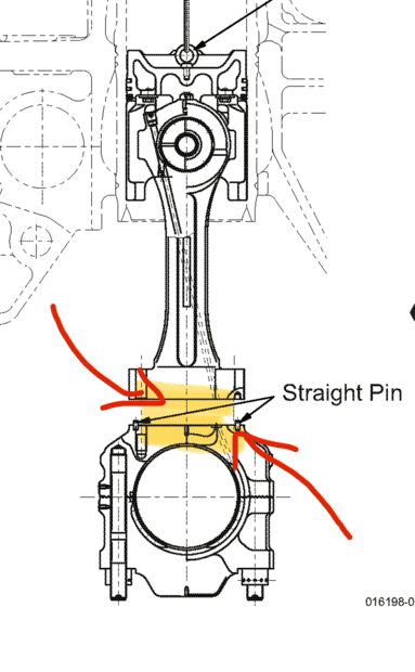

I work with diesel generatora on board of ships. Our major value that is considered after oh and during the maintenance checks is Pmax - maximum cobustion pressure in combustion chamber. It had to be equeal (~ +- 5 bar between each cylinder). I am familiar with all calculations of engine power and pressures etc but little bit rusty now (10 years ago I graduaeted)
During oh connecting rod feet and marine head had to be grinded (pitting)
Coule you please help me with calculating the change of Pmax when we f.e decrease connecting rod height for 0,5 mm. So the comustion chamber will be 0,5 mm bigger

How can you shorten the connecting rod due to pitting?
Sorry for not being exact. Pitting was found on the contact surfaces - big end bearing housing and connecting rod feet, therefore It was grinded 0,5 mm

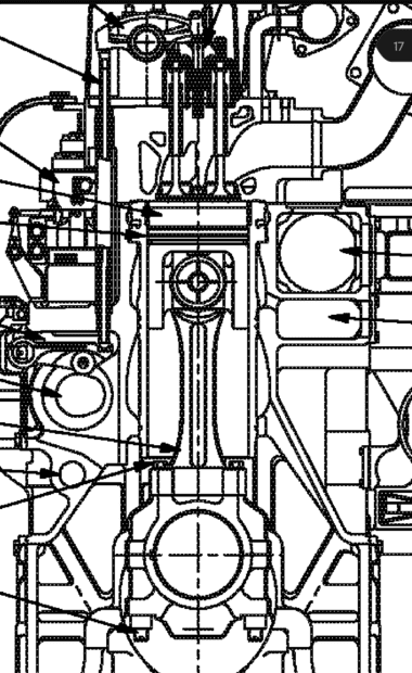

Bottom part is marine head (big end bearing housing) upper connecting rod. Upper part contact surface will be grinded 0,25 mm and bottom also 0,25.
Data that I have posted is from MAN L21/31.
Picture is from Yanmar engine but it is similar
As you can see in the picture combustion chamber is on the top of the piston closed with almost flat cylinder head which is sitting on the liner.

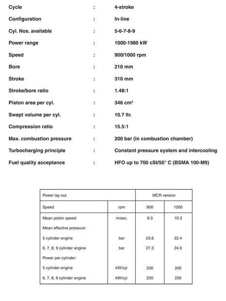

Found some more data. Hope it will help
Likes Lnewqban
Stroke = 310 mm.
Piston area per cyl. = 346 cm²
Swept volume per cyl. = 10.7 litre
Compression ratio. = 16.5 : 1
Pmax - 185 bar on 100% of load
From that we get ...
Minimum volume; 10.7 litre / 16.5 = 648 cc at TDC.
Increase in cylinder volume; 346 cm² * 0.5 mm = 17.3 cc
New minimum volume; 648 cc + 17.3 cc = 665.3 cc
New maximum volume; 10700 + 17.3 = 10717.3
New compression ratio; 10717.3 / 665.3 = 16.11
Volume change ratio; 16.11 / 16.5 = 0.976
New Pmax; 185 * 0.976 = 180.56 bar.
The cooler air will take longer to ignite fuel.
Increase fuel volume by about 2% to compensate.
