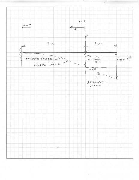

Your equations for slope and deflection (part a) look good, but what you have done (I didn't check your math) is to solve for the deflection at 1 m from the free end of the beam when the load is applied at the free end. That is not what the problem is asking in part b, it wants to solve for the deflection at the free end when the load is applied at 1 m from the free end. So you first must calculate the deflection at the load point using x=0 at that point and L = 2 m. Then the 1 m portion of the beam from the free end to the load just goes along for the ride without bending since there is no load on it. The deflection at the free end can then be found by knowing the slope of the curve at the load point.

Best to find the slope (dy/dx) at the point of application of the load at x=0, then since the shape of the curve from that point to the free end is a straight line (no bending in that region), use basic trig to get the additional deflection to the free end.

that is not the max deflection, that is the deflection at 1 m from the right end. The max deflection occurs at the right end. Solve for the slope of the curve at x= 0 !

Remember we have chosen x=0 to be 2 m from the left end. We want the deflection at 3 m from the left end. Again, solve for dy/dx at x=0 using your equation.

No, we chose x = 0 at the load point and L = 2 because the last 1 m of the beam is stress free and it does not deflect the same way , it just goes along for the ride with a straight line deflection, not a curved cubic deflection. Please solve for dy/dx at x = 0 and what do you get? See attached.
PhanthomJay said:
View attachment 109695 No, we chose x = 0 at the load point and L = 2 because the last 1 m of the beam is stress free and it does not deflect the same way , it just goes along for the ride with a straight line deflection, not a curved cubic deflection. Please solve for dy/dx at x = 0 and what do you get? See attached.
do you mean if th eload is applied at the stress free end , then , we can detremine the max deflection at the stress free end directly by x = 0 , L= 3 , without involving the dy/dx equation multiply with the length ?
Yes.
