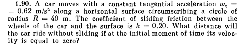

Maximum distance the car accelerates in a circle without skidding

At distance s, the speed of the car is v.
$$ v^2 = 2wτs$$
$$\frac { mv^2} R ≤ kmg$$
Let's denote the maximum distance covered without sliding is smax.
$$\frac { m2wτsmax} R = kmg$$
$$ smax = \frac {kgR} {2wτ}$$
Is this correct so far?
I think you have missed some syntax in your LaTex formatting.
Did you mean so?
$$ v^2 = 2w_τ s$$
$$\frac { mv^2} {R} ≤ kmg$$
Let's denote the maximum distance covered without sliding is ##s_{max}##.
$$\frac { m2w_τ s_{max} }{R} = kmg$$
$$ s_{max} = \frac {kgR} {2w_τ}$$
It is correct.

It is correct.
But should you also consider the tangential acceleration and take the vector sum of that and the centripetal acceleration, when calculating the horizontal force on the car?
Likes haruspex
I agree with @scottdave; if we assume that the tangential acceleration is due to the cars engine (and not, say, someone pushing the car) then the tangential acceleration must also be supplied by the frictional force, and so @Pushoam, your inequality is not quite right.
Likes scottdave
There is a mistake in the question. It should provide the static friction coefficient, not that of "sliding" (kinetic) friction.
Likes scottdave and Chestermiller

Earlier, I had seen that in a uniform circular motion, when there is no force except friction acts on the body, the friction force provides the centripetal acceleration.
Here, you say that there is a component of friction in centripetal direction providing centripetal acceleration and another component in tangential direction.
But, why should one component of friction act in tangential direction?
It is not said in the question that the friction force provides tangential acceleration.
We are going to write the eqn. of motion when the body is moving, so,the question should provide kinetic friction. Isn't it so?

The friction (static here) is providing the net acceleration, so both the centripetal and the tangential.
Static friction acts to oppose commencement of relative motion of the surfaces in contact; kinetic friction opposes actual relative motion.
Consequently, if the friction were kinetic it would be antiparallel to the relative velocity, so subsequent motion would be in a straight line. Kinetic friction will not get you round a bend.

Friction is the only horizontal force acting. ##\Sigma\vec F=m\vec a##, where ##\vec a## is the acceleration of the mass, not just some component of it.

Car's engine couldn't provide centripetal acceleration, but, it could provide tangential acceleration. I am asking this because earlier I assumed that car's engine provides tangential acc. and friction provides centripetal acc.
So, if the question doesn't specify that it's car's engine which provides tan. acc. , then, we have to take friction providing tan. acc. Is it so?/
The car's engine is not in contact with the road. The car only has acceleration in consequence of external forces acting on it, and those all come via the tyre/road contact, gravity and air resistance. Without friction between tyre and road, the engine won't get you anywhere.

Think about what the engine does. It exerts a torque on the axle. Without friction on the road, that would cause the wheel to spin. The friction opposes the tyre sliding on the road, and that pushes the car along.
See if https://www.physicsforums.com/insights/frequently-made-errors-mechanics-friction/ helps.
