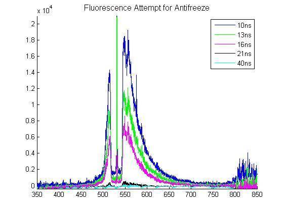

I have taken a time dependent fluorescence series of spectra for an ethylene glycol solution using a 532nm laser as the excitation source. I have attached the spectra to this post. Nothing looks unusual-there is a sharp notch near the 532nm line--this is due to a filter I have used to protect the spectrometer from the laser.
However--note that the spectrum has points to the left of the laser line-e.g. at wavelengths lower (energies higher) than the laser. How does this happen? I don't believe this could be attributed to Raman /anti-stokes processes due to the large separation--usually these shifts are smaller yes? Even though we are dealing with a complex solution here, we cannot expect electrons to become promoted to levels higher than the excitation photons to this extent.

That is difficult to say without knowing what your laser looks like. What kind of laser is it? 532 nm cw? pulsed? If pulsed, fs, ps or ns pulses? It might be worthwhile to check the laser spectrum under identical conditions. To me it seems that at the low intensities considered here, that might just be the width of your laser extending beyond the filter.
I am using a Qswitched Quantel CFR200 532nm NdYAG set at about 20mJ. Pulses are around 7-9ns. The laser is "tight". The green "tower" in the middle of the filter notch is the laser line as seen by our spectro. I am using a spectro with a resulution of bettter than 0.03nm. I see the same effect with a cheap OceanOptics spectrometer.
I have taken some spectra with the power choked down quite a bit (probably ~1mJ). I don't expect that we are seeing thermal effects in the sample contributing here but that is all conjecture of course.

You have to eliminate the possibility that the antiStokes line is an artifact caused by spontaneous fluorescence of the lasing material. The laser that you are using to excite the sample may not be monochromatic.
I recommend that you use a "sanity check". Replace your sample with either an empty cuvette or a scatter plate. A frosty piece of glass (i.e., scatter plate) should have no fluorescence lines. If you still still see the same anitStokes fluorescence line, then you have an artifact.

Thanks for your well thought out reply! I always shoot some "inert" samples to check out the system. The stray spectrum below the laser line is not visible in that case. I believe the laser line to be better than 0.3nm. I took spectra of it a long time ago. This is a solid state high end laser. The spectral lines below 532nm in the attachment cover around 50nm.
The possibility of harmonic generation is quite real. The laser in use is 1032nm NdYag fronted with a harmonic crystal for 532 but I would expect at least some 266nm in there.

Your "antiStokes band" could be a Stokes band from another component of your laser. If there is a 266 nm component to your laser, then it can excite photoluminescence emission in your sample. UV at 266 nm can be absorbed by many materials. Therefore, your "antiStokes" band maybe be Stokes fluorescence or even Raman from your sample or the cuvette.
There are other components that can be generated by nonlinear optical processes. There can be a 355 nm component generated which can also cause fluorescence.
If you are using a diffraction grating in your laser optics, you have to be careful of the high order diffraction. High order diffraction can make a high frequency component of the laser look like an antiStokes line. Second order diffraction can make that 266 nm component appear like a 532 nm component. There are also diffraction "ghosts" that can make that 266 nm look like a narrow spectral band.

You say that you have an ethylene glycol "solution" - What else is in it besides ethylene glycol?
The suggestion of placing a narrow-band filter in front of the laser is an excellent one (if you can find a filter that will withstand those energies), as is the suggestion to record "blank" spectra, e.g with frosted glass.
I believe your laser is flash lamp pumped. I am wondering if you are seeing either part of the flash lamp spectrum, or possibly fluorescence excited by the shorter wavelength components of the flash lamp.
The reference below suggests that ethylene glycol has no visible absorbance, so what you are seeing as emission must come from some other source (e.g. uranine or other dye added as a colorant):
