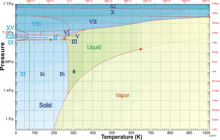

according to the above diagram water will freeze at 58.5 kPa at 260.77K so the experiment will not work ? freezing can stop siphoning i guess.
You're still bogged down on worrying over state (p-V-T) diagrams. There is nothing in your problem statement that says that the water is frozen at the higher elevation. It might be a nice sunny summer day up there! So assume water, not ice, everywhere.
So, as I said, think atmospheric pressure, not vapor pressure.
