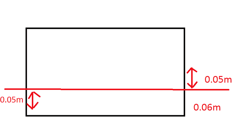

A platform is supported by a rectangular plastic tank below . When there's no external load act on it , it oscillate on the water surface with amplitude 0.05m . When it's in equilibrium , the water reaches 0.07m of the height of tank submerged in water.
P/s : the tank has a height of 0.35m , and base area of 0.5 (m^2) . Assume it is undamped oscillation
what is the maximum load it can withstand so that the platform still can float on water ?
when it's in equlibrium , the tank submerged 0.06m , the amplitude of oscillaltion is 0.05m , so 0.35m - 0.06m -0.05m = 0.24m ? so the maximum load = buoyant force = (0.24)(1000)(9.81) N , am i right ? The weight of platfrom is then subtracted from (0.24)(1000)(9.81) N to get the max load it can withstand...
is my working correct ?

or it should be (0.25)(1000)(9.81) ?

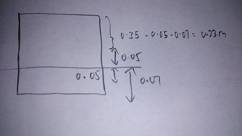

if there's no oscillation , the maximum height of tank submerged is 0.35-0.07 = 0.28m , at h = 0.28 , the platform support the max load
when there's oscillation , the maximum height of water is 0.35 -0.07-0.05 = 0.23m , am i right ?
When the tank is at maximum load, the draft at no load does not come into play, since the tank is now loaded.
The oscillation is going to affect only the maximum draft the tank can have when loaded.
In order to find the maximum load which the platform can support and still remain floating, you want to subtract the minimum draft from the maximum draft. That's what 0.23 m represents in your calculation above, the difference in the minimum and maximum drafts of the tank.
Now, what is the load which the platform can carry?

max weight = (0.23)(0.5)(9.81)(1000) N ?
foo9008 said:
what is the meaning of draft here ? what doi you mean by max and min draft ?
draft is the distance at which the waterline is located above the bottom of the tank, i.e., how deep the tank sinks into the water when it is floating.
Turn the crank and how many Newtons is that?
BTW, per the discussion in Post #25, this is the maximum weight the tank can carry and remain floating.

so , the max weight = (0.23)(0.5)(9.81)(1000) N ? is correct ?
  • #31
If we assume the amplitude of the oscillation is still 0.05m, yes. But the question does not make that clear. Why should the amplitude stay the same? With the extra load, the energy flux is greater for the same amplitude. If we were to add some mass, gently, when the tank is at the equilibrium position the amplitude would decrease. Add the right extra mass at the lowest position and it would stop oscillating entirely.
