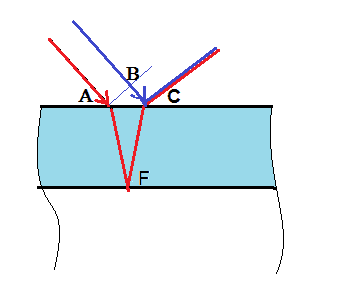

Actually, the ray travels 2d/cosβ in the layer. And the optical path has to be taken into account when calculating interference, which is the geometric path multiplied with the refractive index. The other ray it interferes with, reflected directly at the interface, also travels some distance from their common phase plane AB. The optical path difference between the blue and red rays is 2 n AF -BC.
Agreed!
The phase difference in the plane wave, as you specified
2 n d / cos β - 2 d tan β sin α does simplify to 2 n d cos β
since sin α = n sin β
