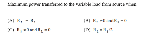

Maximum power is transferred to variable load when:
1) RL = Rs
2) RL not equal to 0. and Rs = 0
3) RL = 0 and Rs not equal to 0
4) RL = Rs/2
Maximum power theorem RL = Rs
But if Rs = 0, then current is maximum, so load get maximum power. Shouldn't answer be B. Book answer is A.
I tried with a 4V dc source and 1 ohm source resistance and 1 ohm load resistance.
Power = 2^2 / 1 = 4.
In second case I put source resistance = 0.
Power = 4^4 = 16.
OK, so with Rs equal to zero, what value of RL gives you maximum power to the load?
Likes jaus tail
With Rs = 0, RL can be whatever is needed. That depends on load requirement. Max power = V2 / RL. Oh yeah. max power is when RL = 0, which is Rs
I guess if RL is not variable when Max power is when Rs = 0.
lol when Rs = 0, max power is infinite and everything goes boom :D
1) RL = Rs
4) RL = Rs/2
Are you quoting this fully & accurately? If so, then the question gives no indication what they might mean by the terms RL and RS?
Making likely assumptions, (2) is undoubtedly correct. Load power is maximised when there are zero source losses.
Likes jaus tail
Yes the question is same except: Max power is transferred to variable load from source when
But the books have clear indication as to what is Rs and RL

It seems like a trick question.
Likes jaus tail
You haven't fully addressed scottdave's question. Suppose RS is zero ohms, describe the value of load that will make the load as hot as possible.
For max power, maximum current which means RL should be zero. Short circuit.
This value matches of Rs = 0.
Certainly, as resistance approaches zero, power approaches infinity. I'm not sure how to view the exactly zero ohms case.
Do you know which answer your test is marking correct?
There's a big difference between delivering maximum power to the load (as many watts as possible), and delivering maximum proportion of power to the load (i.e., maximum efficiency; lowest loss in source). The former is met by RL = RS, the latter by setting RS=0 (or RL » RS).
Likes donpacino, anorlunda and jaus tail
Book says right answer is A.
Yeah you're right. For max efficiency, Rs = 0.
There's a fun anecdote about that difference. When Thomas Edison started the first electric power company, he set RS=0. The electrical engineering societies called him an ignorant fool because they all knew that maximum power is transferred when RS=RL. But those engineers were used to working with a battery where VS and RS are fixed. Edison knew that with his generator, he could adjust VS to be anything he wanted. Edison also knew that the proper question is not maximum power to the load but rather minimum power lost in the source.
Likes donpacino
As an undergraduate student I had trouble understanding this at first. I remember debating with my professor the exact point jaus tail was trying to make.
If only our teachers could say it as succinctly and clearly as @NascentOxygen did.
Likes jaus tail
