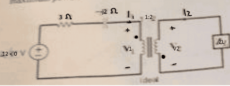

Given the following circuit find the value of ZL for maximum average power transfer and find the maximum power.
n = N2/N1
V2/V1 = N2/N1
I2/I1= N1/N2
move ZL from the secondary coil to the primary coil using Zs* = ZL/n^2
ZL = 4(3+2j) = 12 +8j
P = (12)^2/ [(8)(12)] = 1.5W
I want to verify if this is the right method
Right.
This is incorrect. Looking at the equivalent circuit referred to primary, which formula will you use for calculating power dissipated in the load?
Likes OmniNewton
cnh1995 said:
Right.
I see thank you for the response. When dealing with this problem would you determine the current I by dividing the given voltage by the sum the 2 impedances. Then we can say that S= I^2Z so P = the real component of S
Right.
Note that the power you get will be the real power since there is no reactive power in the circuit. So, S=P.
And this would be the maximum power?
Yes.
Likes OmniNewton
Thank you sir!
