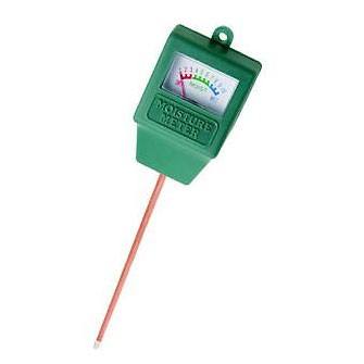

I'm not clear on whether cost is the primary hurdle or limits are imposed by an instructor that require you to DIY. Anyway, I know very little EE but it occurred to me that the following ultra cheap little device (this one's eight bucks) measures moisture according to the soil's conductivity. I wonder if it's calibrated, or could be recalibrated with a bit of tinkering, to roughly measure salinity in water samples. It doesn't even require a power source.
http://eartheasy.com/soil-moisture-meter
