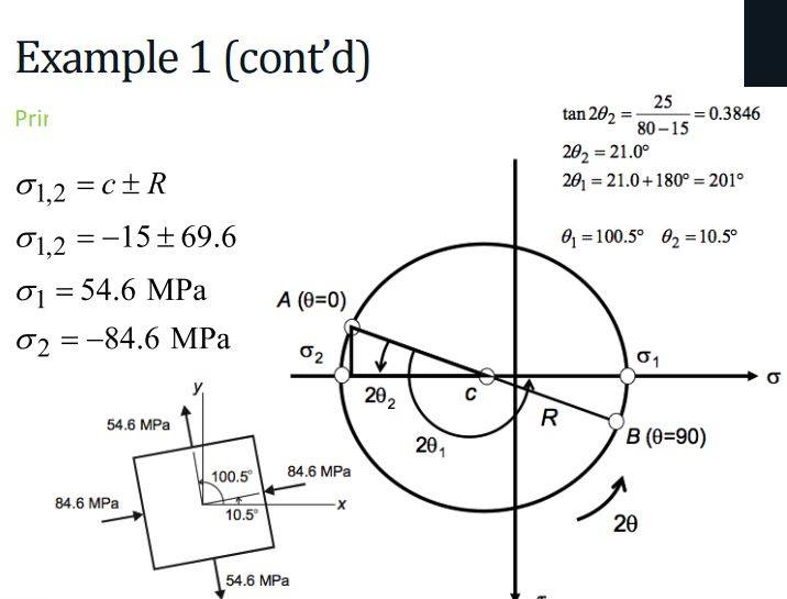

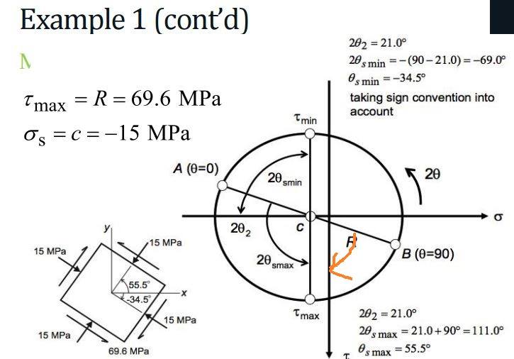

I am not sure how to get the maximum shear force in mohr's circle [/B]
To get the ##\theta_s max ## , we have to 'turn' the B to ##\tau_{max}## , right ? So , it should be like this ( in the figure , orange arrow) ? Am i right ? Since at A , the shear stress is negative , we can only get the minimum shear stress by 'rotating ' the A to ##\tau_{min}## ? It 's not possible to get the maximum shear stress like the author do at point A , right ?

sorry , due to slow internet connection , it's here

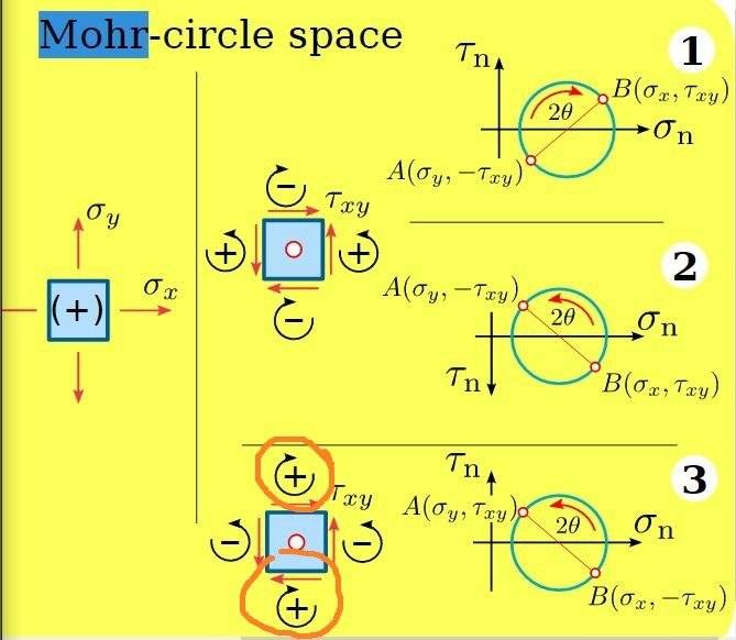

https://en.wikipedia.org/wiki/Mohr's_circle#/media/File:Mohr_circle_sign_convetion.svg
I don't really understand the explanation in circled part .
From the diagram we , we can see that the shear stress that cause the element to turn clockwise is positive , but in the word there , the author stated that the shear stress that cause the element that to turn clockwise is negative ... So , which is correct

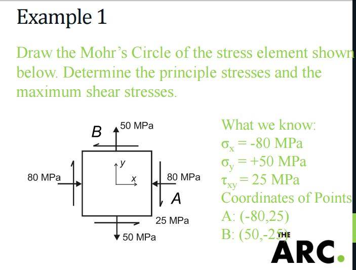

According to the Wikipedia article, the ##\tau_{xy}## in your figure should be -25, not + 25. This is the sign I would have assigned to it also.

so , the author 's coordinate is correct , right ? He lets's A = (-80, 25) because at the surface where the -80 normal stress act perpendicularly , the shear stress 25 will turn the plane clockwise , so , according to the wiki (no3) , when the shear stress turn the palne clockwise , it's positive shear stress , right ?
What kind of crazy sign convention is this. By the usual convention, ##\tau_{xy}## is defined as the shear stress on a plane of constant x (for which the outwardly directed normal to the plane is pointing in the + x direction) in the + y direction. According to the figure, that would make ##\tau_{xy}## equal to -25 on surface A.
So, according to what you're saying, in Figs 5 and 6 in the Wikipedia article you cited, since ##\tau_{xy}## is pointing upward on the right hand face of the block in the figure, its value is actually negative rather than positive (since it is pointing in the opposite direction of the shear stress shown in your homework problem).

yes , in that figure , we could see that the author put A at (-80, -25) in the mohr's circle although he stated wrongly that A = (-80,25 0 in the first figure . so , what are you trying to say ?
Which version of the problem do you want to solve?

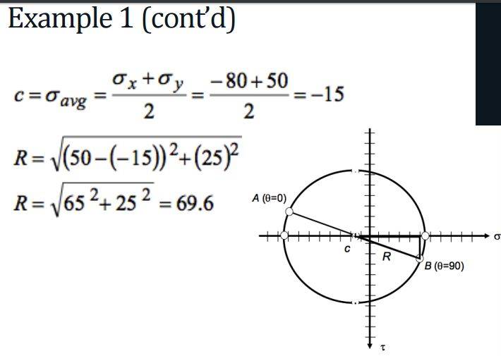

Case of ##\tau_{xy}=+25##
First calculate ##\tan{2\theta_p}##:
$$\tan{2\theta_p}=\frac{2\tau_{xy}}{(\sigma_x-\sigma_y)}=\frac{(2)(25)}{(-80-50}=-0.38462$$So, $$2\theta_p=-21.04\ degrees$$
Next calculate the average of ##\sigma_x## and ##\sigma_y##:
$$\frac{\sigma_x+\sigma_y}{2}=\frac{-80+50}{2}=-15$$
Next calculate radius of Mohr's circle:$$R=\tau_{max}=\sqrt{\left(\frac{(\sigma_x-\sigma_y)}{2}\right)^2+\tau_{xy}^2}=\sqrt{(-65)^2+(25)^2}=69.6$$
Next, use the following equations to calculate the normal and shear stress components on a plane normal to a unit vector pointing in the direction of a the angle ##\theta## measured counterclockwise relative to the x axis:
$$\sigma_n=\left(\frac{\sigma_x+\sigma_y}{2}\right)+\frac{(\sigma_x-\sigma_y)}{2}\cos{2\theta}+\tau_{xy}\sin(2\theta)$$
$$\sigma_t=-\frac{(\sigma_x-\sigma_y)}{2}\sin{2\theta}+\tau_{xy}\cos(2\theta)$$
The minimum principal stress occurs at ##2\theta=2\theta_p=## = -21.04 degrees. The value is -84.6.
The maximum principal stress occurs at ##2\theta=2\theta_p+180## =158.96 degrees. The value is +54.63.
The following is a table of values for ##2\theta## (degrees), ##\sigma_n##, and ##\sigma_t##:
The sequence of values is in the clockwise direction.
I changed my mind about doing tau=-25. This has gotten too time-consuming. I leave that case for you.
Chestermiller said:
Are you familiar with matrix operations, such as multiplying a matrix by a column vector?
No , i learned it , but i didnt master it well. so , i am having difficuties of understanding it
  • #34
Is there any other way than the matrix method to check my sign convention ??
  • #35
I'm trying to think of another way, but have not been successful yet? Are you saying that you could not multiply a 2x2 matrix by a 2X1 column vector? By any chance, are you familiar with dyadic tensor notation?
Not having the most appropriate mathematical tools to analyze this stuff makes it much more difficult to learn. It's like trying to do mechanics without knowing calculus.
