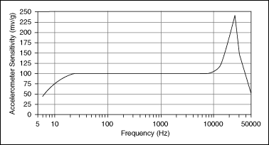

You need to know the output resistance of the piezo sensor and you also need to know how much voltage it generates at that frequency for a given force input. Here is an example of the chart you need for whichever accelerometer you have:
Here is more information on accelerometer selection. http://www.ni.com/white-paper/3807/en/ If your goal is to generate power, I'd pick one that resonates at 200hz or whatever frequency the input from the machine will be.
When you know the voltage output per-G of acceleration at a given frequency, and you also know the output resistance, you can then calculate wattage.
