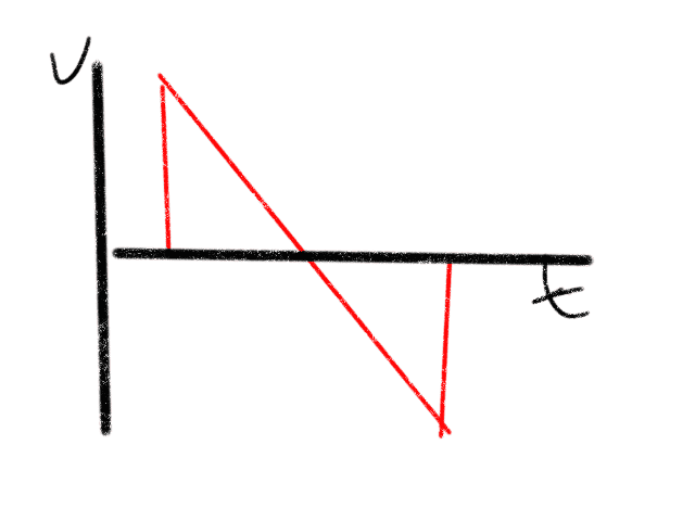

Hey so I encountered a problem recently, which while being simple, gave me another problem that I couldn't solve.
The problem:
An object is launched vertically upward with an initial velocity of 10 m/s from an elevation of 20m and allowed to hit the ground. Develop the equations of motion between elevation & velocity vs time. Also find the maximum elevation and maximum velocity attained by the object.
The first part was too trivial to mention here. It was the second part that got me.
The maximum elevation was quite simple. I had an equation for elevation vs time. All I had to do was differentiate it and set it to zero. I noticed that this was intuitive because the derivative of elevation would be velocity and since this is projectile motion i.e. constant acceleration, its velocity at the highest point would be zero. And thus I was able to find the max elevation.
However, when it came to max velocity, I thought I could simply do the same thing again, since I had an equation for v vs t. But then I realized that if I differentiate that equation, I get acceleration, which is constant and not equal to zero.
This means I can't use the maxima/minima property of derivatives to find max velocity. Why didn't that work?
Okay I see now that the velocity increases linearly, meaning its graph on v vs t is a straight line. As such, its maxima and minima are at +
\infty
and -
\infty
respectively. Which is probably why it didn't work.
Is this only true for straight lines or are there other curves where the maxima-minima property doesn't work? Or at least, isn't useful

Because the object hits the ground and so the function is discontinuous.
The maximum( absolute(velocity) ) will be when the height, y = 0.
Since the answer was given, I’ll give the why’s
1) Mathematically, you also have to check the boundaries which are t=0 and when the projectile hits the ground.
2) Physically the potential energy is lowest when the projectile hits the ground so the kinetic energy (i.e. velocity) is at its maximum.

For this case, yes. But imagine the line y = x. It is indeed continuous everywhere but when you calculate the derivative, dy/dx = 1, which can't be set to zero. That's kind of what I was asking. Does this function not have a maxima/minima?

In general, when calculating extremum you also have to check the values at the boundaries. For this problem, the boundaries are when you launch the object and when the object hits the ground. The equations that you developed are invalid outside this region.

Yes, at the end points. Points with zero derivative are not the only possibility for maxima and minima.

##dy(x)/dx=0## is only the definition for local extrema. There can be global maxima or minima at the endpoints of the interval of interest.

In general, you also have to look for discontinuities and points where the function is not differentiable. For example, there is a local and global minimum of the modulus function at ##0##, where the derivative does not exist.

Part of the problem here is that you aren't modelling the velocity correctly. It's not ##\vec{v}=(v_{x0},v_{y0}-gt)^T##, it's $$\vec{v}=\left\{\begin{array}{ll}(v_{x0},v_{y0}-gt)^T&0\leq t\leq T\\(0,0)^T&\mathrm{otherwise}\end{array}\right.$$where ##T## is the flight time and the subscripted ##v## are initial velocity components. That's because your projectile was stationary before launch and becomes stationary again when it hits the ground. So your vertical v/t graph isn't just a straight line, it's actually more like this sketch:
Simply taking the derivative of ##v_{y0}-gt## ignores the discontinuities and assumes the projectile is in motion forever. But there are actually three phases of its motion with discontinuities in the velocity between them. And those, as others have commented, you have to check for separately from your calculus.

More formally, a point ##x## is a "local maximum" of a function ##f## if and only if there is some finite neighborhood around ##x## where the function attains no value greater than ##f(x)##.
Or more formally yet:
##f## is defined at ##x## and there exists a real number epsilon (##\epsilon##) greater than zero such that for every point ##y## in the open interval from ##(x - \epsilon, x + \epsilon)## that also falls within the domain of ##f##, ##f(y) \le f(x)##.A point ##x## is a "maximum" or "global maximum" if there is no point anywhere within the domain of the function where the function attains a value greater than ##f(x)##.Given the above definitions, we can prove the following:
If a point ##x## is a local extremum of a function ##f## then one of the following must be the case:
1. ##f## is not differentiable at ##x##.
E.g. ##f(x) = |x|## with a minimum at ##x = 0##, but ##f## has no first derivative at ##x = 0##. This function has no maximum.
2. ##f'(x) = 0##
E.g. ##f(x) = x^2## with a minimum at ##x = 0##
E.g. ##f(x) = 1##. A degenerate case with a global maximum and global minimum everywhere
3. ##x## is a boundary point in the domain of ##f##
E.g. ##f(x) = x## for ##0 \le x \le 1## with a minimum at ##x = 0## and a maximum at ##x = 1##
