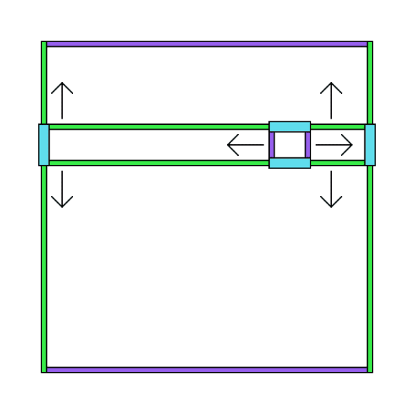

First let me explain the diagram above:
Green: Rails (upon which each carrier rides).
Purple: Non-rail pieces of frame.
Blue: Linear bearings & motor blocks.
The device sits horizontally. I was using gravitational acceleration in the expression for normal force. The issue is that I would calculate for torque if there were a reliable way to figure the mass of each carrier, which will fluctuate depending on the camera in use (which sits in the middle carrier), and the lighting in use. As a result, I have chosen to find a maximum mass that can be carried by a motor and have used 20 N×cm for the purpose of demonstration (in the math above).
Yes, the mechanics in the system are driven via steppers on rails. However, they are paired with linear bearings (created using cast steel bearings and C-channel). In order for this to make sense, allow me to describe the restrictions placed on the design of this machine:
1. The device must be expandable in order to work with images of various (large) sizes.
This is because the device is intended to be portable and reconfigurable; it will often be used on-site.
As such, the largest rails (as well as those carried by the larger carrier) are broken into 2-foot sections which are held together by a system of coupling braces (such that the top of the rail is smooth).
2. The device must be made with low cost materials.
This device need be budget friendly such that an archival department anywhere can afford to create their own.
Precision, again, is not paramount, the way that the device will function leaves margins on the edge of each photograph composing the whole scan, the program that stitches these images works well with margins, and thus can cope easily with a fairly large degree of imprecision.

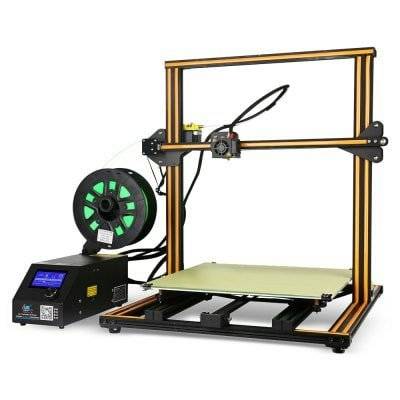

Have u looked at xyz core 3d printers? Ur set up is very similar to its mechanism. Depending on the mounting of the camera on the moving profile, u do need to know its inertia.
deuel18 said:
Have u looked at xyz core 3d printers? Ur set up is very similar to its mechanism. Depending on the mounting of the camera on the moving profile, u do need to know its inertia.View attachment 210077
Yes, that is very similar, apart from being vertical.
I'll have to work out the inertia, but as a bit of helper, I have been coding a fairly robust PID controller for each of the carriers, with a large enough derivative gain, the carrier should speed up and slow down well.
Also, the motors are now servos instead of steppers due to cost restrictions.
