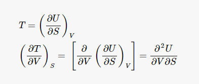

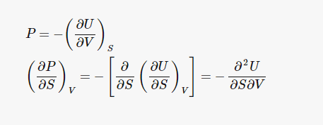

Show that: [itex] (\frac{∂T} {∂V})_S,_n=-(\frac {∂P} {∂S})_V,_n [/itex]
[itex] dU=TdS-PdV+μdn [/itex]
[itex] \frac {∂} {∂S} (\frac{∂U} {∂V})_S,_n=-(\frac {∂P} {∂S})_V,_n [/itex]
[itex] \frac {∂} {∂V} (\frac{∂U} {∂S})_V,_n=(\frac{∂T} {∂V})_S,_n [/itex]

It looks like you already had it in your first two equations of Attempt at a Solution. You are aware that 2nd partial derivatives with respect to two variables are interchangeable (commutative), correct?

If I say they are equal, I am assuming that Schwartz relation is valid in this case, or that U is a continuos function. I want to demonstrate why Schwartz relation is valid.

It's observed experimentally. Does that count as proof? Otherwise you need to start looking into statistical thermo.
Chet
Mmm statiscal thermo is a subject I will study next year, so if there's no other proof I suppose experimental proof is what I need.Thank you.
