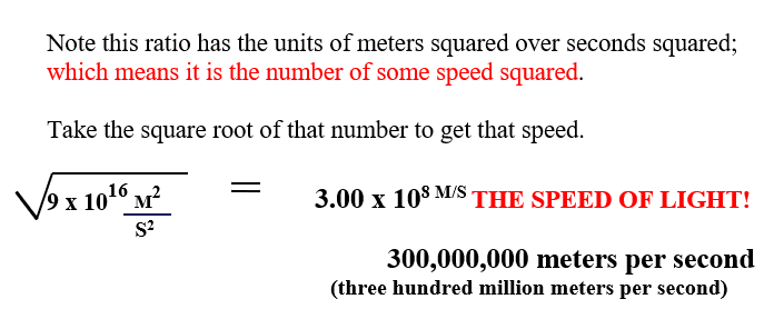

I'm studying history of electromagnetism. Here is my question regarding Maxwell's classical brilliant work.
I understand these constants (for now)
And I understand this:
But I need to understand how this math below gets us to the speed of light. I don't understand the MATH. Just educate me on the math of this below and how the fraction below get me to 3 x 10 to the 8th. thanks.

Thanks -yes I need to clarify. Look at the way I arrived at the speed of light from simply dividing the two constants and taking the square root of that. I saw that somewhere on the web. Then look at the more classic formula at the very end. That may be Maxwell's derivation or someone else's method. But I'm told that that last equation on my question, also gets you to the speed of light. I do not understand how that fraction is manipulated mathematically to get 3 x 10 to the 8th power (speed of light in m/s).
You multiply ε0 by μ0, take the square root, and take one over that. That gives you the speed of light. I think I'm still missing your question.
mu symbol of course is the magnetic constant and epsilon is the electric constant. That I know. My problem is math. But one would have to be dividing them instead of multiplying them and I don't know how one does the math.
What does "take one over that" mean?
No. You don't divide them. You multiply them. It's not quite the same as your first example.
If I have a number like 2, and I take 1 over it, I get 1/2, which is 0.5.
It's what the[itex] \frac{1}{x}[/itex] button on your calculator does.

I do use a calculator. That is not my question. That is how I did the first calculations I posted here. And of course got the speed of light when I DIVIDED one constant by the other; took the ratio of the two with the electric constant as the numerator. Then taking the square root of that (on my calculator) I got the speed of light. That method I saw in a video of Maxwell's life.
Let's start over again. My problem is that the equation I'm asking about is the one posted below. So note that the method does not divide (take a ratio) of the two constants but in fact multiplies them. So it is a different approach then what I first saw in the aforementioned video.
So the first thing I noticed was that and it confused me. I'm really not needing to understand how that was derived not now. I was just curious how the process had changed from division to multiplication of the two constants. So we can skip my question of how this equation was derived.
My main question now is that the constant values I obtained from the video confused me because, below those values are different, meaning we are talking about a different approach to the whole question. Can anyone explain why the values of the constants are different in my original post than those in the equation immediately above?
I'm sure I seem naive to most of you but thanks for trying to work with me on this. I'm reviewing algebra and starting into calculus also so I'm hoping to get more sopohisticated about this.

One way to see the difference is to realize that the constants you called Ke and Km in your original post are related to ε0 and μ0 by:
Km = μ0 / (4π)
Ke = 1/(4 π ε0)
So [itex] \frac{K_e}{K_m} = \frac{1}{\epsilon_0 \mu_0} = c^2[/itex]
Likes Socius
The equation ##c = 1 / \sqrt {\varepsilon_0 \mu_0}## implies SI units (Système Internationale a.k.a. "meter-kilogram-second"), which were codified after Maxwell's time. Maxwell used different units for electromagnetic quantities.

I don't know, whether the question has been answered. There are two questions in one, namely about the mathematics of how to derive this result (that's quite easy to answer with sufficient math) and the historical one. The latter is very interesting but involved. The point is that electromagnetic waves have not been discovered yet. They were a prediction of Maxwell's theory. What was known of course was the speed of light, but it was not known that light in fact is a electromagnetic wave (at a frequency/wavelength the receptors in our eyes are sensitive to).
Here's the math. We start from Maxwell's equation for free electromagnetic fields, i.e., for a space-time region were no charges and currents are present, using SI units (spoiling of course the beauty of Maxwell's original equations)
$$\vec{\nabla} \times \vec{E}+\partial_t \vec{B}=0, \quad \vec{\nabla} \cdot \vec{B}=0, \quad \vec{\nabla} \times \vec{B} -\mu_0 \epsilon_0 \partial_t \vec{E}=0, \quad \vec{\nabla} \cdot \vec{E}=0.$$
The trick is to get rid of ##\vec{B}## from the 1st equation (Faraday's Law of Induction) by taking its curl:
$$\vec{\nabla} \times (\vec{\nabla} \times \vec{E}) + \partial_t \vec{\nabla} \times \vec{B}=0.$$
Now the "double curl" simplifies with the last equation to
$$\vec{\nabla} \times (\vec{\nabla} \times \vec{E})=\vec{\nabla} (\vec{\nabla} \cdot \vec{E}) - \Delta \vec{E} = -\Delta \vec{E}$$
while according to the 3rd equation (the Ampere-Maxwell Law)
$$\partial_t \vec{\nabla} \times \vec{B}=\mu_0 \epsilon_0 \partial_t^2 \vec{E}.$$
This indeed gives a wave equation for the electric field components alone,
$$(\mu_0 \epsilon_0 \partial_t^2 - \Delta)\vec{E}=0.$$
The phase velocity of the waves, ##c##, thus obviously fulfills
$$\frac{1}{c^2} = \mu_0 \epsilon_0.$$
Now, ##\mu_0## and ##\epsilon_0## can be thought of being measured with help of static (sic!) sintuations, given the unit of electric charge and currents, and that's indeed how historically the numerical values were found. Of course, it was in terms of the more natural electrostatic and magnetostatic systems of units, but the principle is the same as within the SI units, and indeed what you find when plugging in the values of the permeability and permittivity of the vacuum (which are despite their fancy names just arbitrary conversion factors to define the SI unit of electric currents, Ampere), is that ##c## agrees very well with the measured speed of light in a vacuum, and that's why Maxwell came to the conclusion that light is just an example for these waves.
