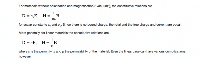

D is related to the E field and is described in more detail here:
http://en.m.wikipedia.org/wiki/Electric_displacement_field
Similarly for H is related to the B field:
from the wikipedia article on Maxwell's equations.
