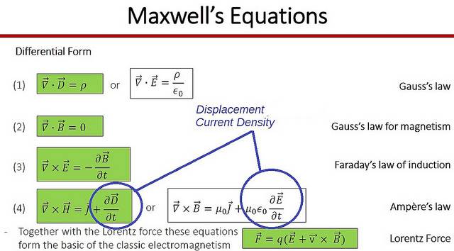

So, I was studying Maxwell's equations and I don't really understand the last one - Ampere's Law (with Maxwell's extra term added in). The bit I'm not able to understand is the term Maxwell added. How exactly does a changing electric field through a closed loop induce a magnetic field along that loop?

It is because change in electric flux density (also known as displacement current density) creates magnetic field in the same way as the Faraday's law. For example, the change of electric flux density between two plates of a capacitor will induce circular magnetic field around the space between the two plates as though a current were present there as well.

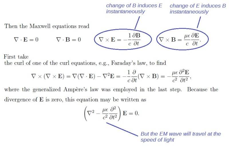

It is very misleading to say that an "electric field is created, which, in turn, creates a wiggling magnetic field... and again and again in the same way... are electromagnetic waves". To begin with, there's only one electromagnetic field, represented in the classical form by its electric and magnetic components ##\vec{E}## and ##\vec{B}## (I refer to the microscopic fundamental laws; the further split into free and internal fields in macroscopic electromagnetics is another more complicated topic of its own).
The Maxwell equations split into two classes, the homogeneous equations
$$\vec{\nabla} \times \vec{E}+\partial_t \vec{B}=0, \quad \vec{\nabla} \cdot \vec{B}=0,$$
and the inhomogeneous ones
$$\vec{\nabla} \times \vec{B} - \frac{1}{c^2} \partial_t \vec{E}=\mu_0 \vec{j}, \quad \vec{\nabla} \cdot \vec{E}=\frac{1}{\epsilon_0} \rho.$$
The homogeneous equations are constraint equations for the field components, and the inhomogeneous equations provide ##\rho## and ##\vec{j}## as the sources. This becomes clear from the fact that the solutions of the equations are the retarded fields given in terms of the retarded propagator with the charge-current distributions as the causal (!) sources. See, e.g.,
https://en.wikipedia.org/wiki/Jefimenko's_equations
particularly the section "Discussion" therein.

Charge-current distributions is certainly the source of EM field no matter it is static or varying. However, the electromagnetic waves can still propagate in the space even after the source ceased to exist, so the problem is whether or not we can explain the propagation mechanism of EM wave in words as looping of mutual induction of electric and magnetic fields.
