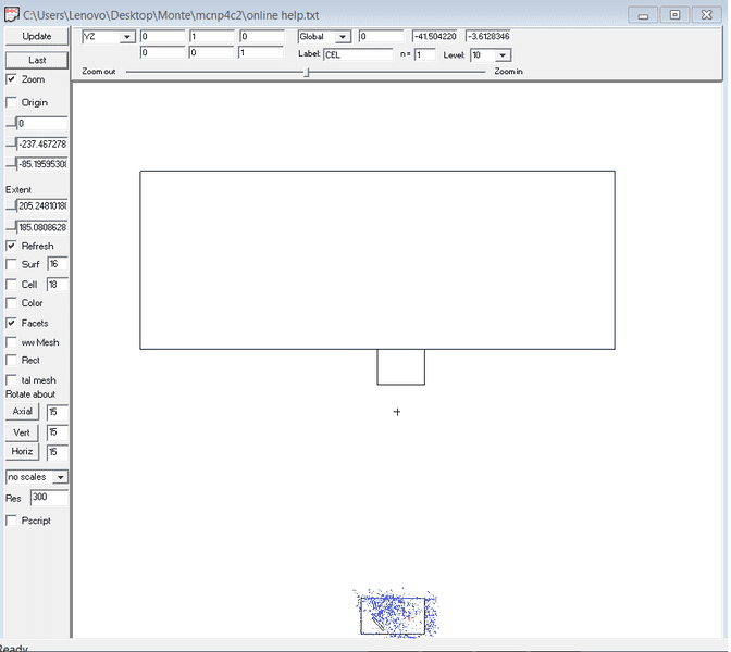

Sorry for the late response.
I have updated the code, but still the F4 and F6 tally in cell 15 was zero.
The source came out from the X-ray tube could not reach the tally box and even the plastic phantom behind.
Is there anything wrong about the geometry? Thanks a lot!
How much nps or tme did you run ?
I tried my file and it is ok but iit is monte carlo so you must have a signifiant run time.

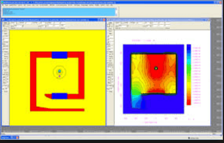

I would like to calculate the dose rate like the above graph.
So, I have to define the every small cell inside the room?
Any other method to do this?
Thank you.
ok I understand. you want to calculate isodose.
for that you can use a "meshtally"

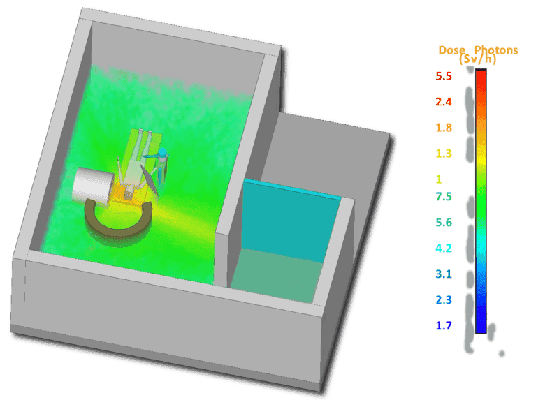

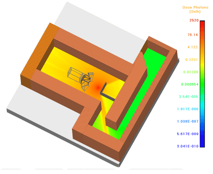

Dear Eva,
My advice is if you have budget for that is to procure Rayxpert software you solve your problem in the day !
just a quick example that we can do with !
regards
