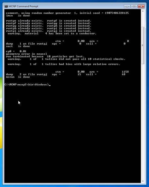

Hello everyone,
trying a run I've got the following error message, and thus no output file since the run stopped by itsefl.
Please, has anyone encountered this error and would happen to know how to correct the input file ? (any hint help)
Thanks to all of you
Hi,
like in the french forum (private joke) it is a geometry error,
PSR
Hi,
thanks to you, I found the error
i encountered this error too but i got ouput... i put the point source near the interface of two cells and the error arises
