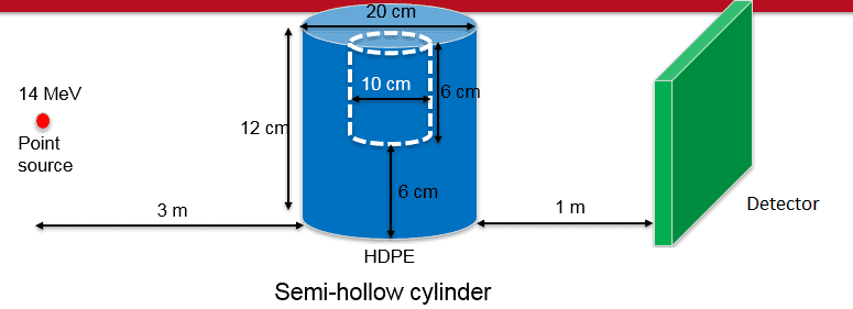

Hi,
I have been doing some simulation with MCNP. They take a long time. I think there is a way to ignore some particle histories, which reduces the time for simulations. In my model, there is a point neutron source, an object, and a detector. Most of the neutrons do not reach the detector. So, I want to ignore them. Can anybody give me a resource from which I can get some information?
Thank you in advance!

In general, the methods you are looking for are called "variance reduction methods".
They are described in the MCNP manuals and after doing a quick google search, I found the LANL report "MCNP Variance Reduction Examples".
https://mcnp.lanl.gov/pdf_files/la-ur-12-25907.pdf
There are a lot of variance reduction methods available, and they can be applied to both energy and space.
To recommend a specific method to use, we need to know more about the problem
* What is the source energy?
* What is the geometry?
* What is the detector reaction?
In addition, this isn't really a variance reduction technique, but if you have a high energy neutron source, and a target with a high energy threshold,
you can also set a cutoff energy to instruct the code to ignore any particles that fall below the cutoff. Refer to the manual for more information.

I am using 14-MeV neutrons. You can see the simplified set-up below.
Both the object and the detector contain Hydrogen and Carbon. As for the reactions, I am assuming all possible reactions inside the object. However, radiography tally is tallying neutron flux. So, I am not sure if every possible reaction occurs inside the detector.
(The object and the detector are not scaled. Assuming the detector is big enough)

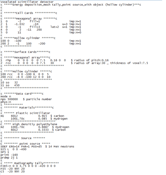

It is kind of a real-world scenario. So, I do not want to change the dimension of the geometry so much. There are three cells whose importance must be 1. Otherwise, MCNP gives an error.
Please see the input file below.

Hi,
the geometry "11 So 450" is very big.Why don't you try a
parallelepiped 420x12x20 something like that
for you fatal error try to copy/paste your file (or put it in ASCII)
PSRB191921 said:
Hi,
I tried rectangular parallelepiped, however, the time that it takes for the simulation to complete was pretty much the same with when a sphere was used. Even it was a little bit longer (I do not know why).
I tried cone beam instead of a point source. The number of neutrons reaching the detector was higher, however, it took a day for 1.5e4 particles. I am not sure if there is a way to reduce computer time while not compromising statistic.
