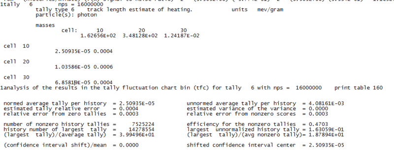

i need to kerma in air, but, i found very low results. I need multiplicate my results per 16000000 to found the valor?

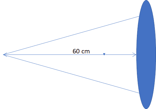

I want simulate a mamography machine with focal point the 60cm the breast. My card "SDEF" is configured for a one-dimensional collimated beam in direction the -z axis.

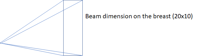

For geometry I am not sure to understand. Do you want to simulate a beam like this :
and

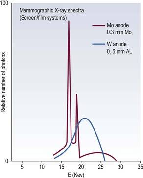

Furthermore a mamography device not emitted a monocinetic energy of photon. For example :
In first approximation a photon of 18 keV like in your simulation could be ok.
Hope it's help

I understood everything your said, but, when I multiply my results in mev / g by 1.602E-10, I get very low results for what I want.
In cell 30 (semi-circular cylinder of air. to obtain kerma in air) i obtained = 6.01751E-05 (mev/g per history). multiplyed by 1,602E-10 i obtain 9,64E-15 (Gy por history).
my fluence obtained in cell 30 is 4.41740E-03 (1/cm**2)
I simulate one million histories. 4.867E+06 histories/minute.
please, help me in this question.
Your result is 9.64E-15 Gy for one Xrays emitted by your device.
You must known the flux of your device in Xrays/s and multiplied the flux by your results and you have Gy/s
