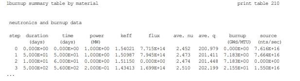

I want to see the data table in the output file as in the following picture
Not sure what you are trying to do here. Number of timesteps = 2. Timestep 1, number of materials =1, material 1, number of isotopes [missing but it clearly should be 1], ZAID1 is U235, C1... Then the same problem with Timestep 2.
This should be an example of a fixed syntax, maybe, but I don't know if it is meaningful. This changes two different isotopes at two different points in time and might not be what you intended.
