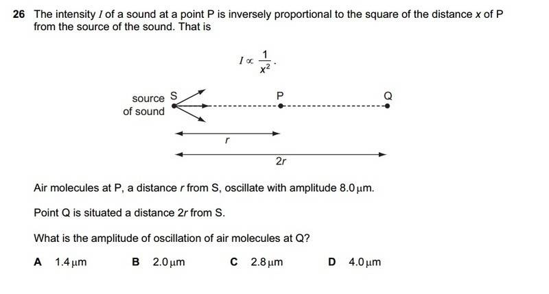

MCQ about intensity of sound waves (formula manipulation)

I took the square root of 8, 8 being the Amplitude and I being proportional to the square of A. (I make the constant of proportionality 1). That's not the answer.
If [itex]\ \displaystyle I\propto\frac{1}{x^2}\,,\ [/itex] then [itex]\ \displaystyle I=\frac{k}{x^2}\,,\ [/itex] where k is the constant of proportionality.
This means that [itex]I\cdot x^2=k\,,\ \text{ a constant}\ .[/itex]

Obviously, but we can't find k here because we don't have a numerical value for x OR I.
You don't need to calculate k.
At point P, we have I=k/r^2
Write a similar expression for the intensity at Q and compare it with the above expression.
You are given an amplitude, A, at point P.
Also, [itex]\ \displaystyle I\propto\frac{1}{x^2}\,,\ [/itex] and [itex]\ \displaystyle I\propto{A^2}\ .\ [/itex] This means that [itex]\ \displaystyle A\propto\frac{1}{x}\,,\ [/itex] assuming they're both positive. Therefore, Ax = k, where k is some constant.
You don't need a numerical result for k.
Ax at P
is equal to
Ax at Q .
@ P, A = 8μm and x = r .
@ Q, x = 2r , what is A ?
A is inversely proportional to x. So if A is doubled, x will be two times less. So if A at x is 8, A at 2x will be 8/2 which is 4.
