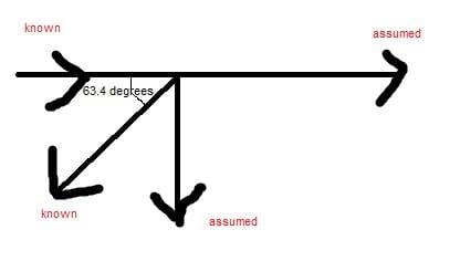

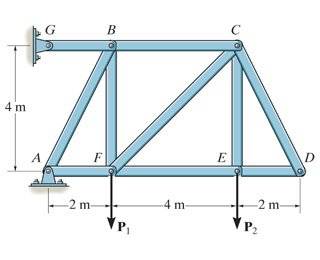

This is my example problem:
Find the internal forces in B.
Skipping a couple of steps ahead I know that the correct answers for GB=27.5 (Tension) and AB=28 (compression).
Now drawing the FBD according to the convention laid out by the book:
I realize that I could infer that the force going in the Y direction HAS to be positive in this case, but I chose a simple example for simple calculations. Let's pretend like we didn't know which direction it should go and simply follow the book's suggestion that we draw all unknowns as tensile forces.
Now for my math:
∑Fy=0=-28Sin(63.4)-BF
BF=-25.04
This is NOT correct. The correct answer is 25.04 as we can tell by inspection.
Why did you draw AB in tension but state it is compression?
I was under the impression that if it was in compression at AB the arrow would go the same way at point B. My bad. I figured out what I was doing wrong last night, thanks though :).
