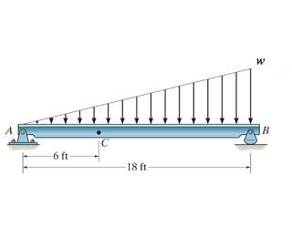

W= 3kip/ft.
Find the shear force and moment at C.
Skipping some initial steps, I found the reactions to be Ax=0 and Ay=9
These are known to be correct.
Now, slicing the beam from a to c.
I get Ay=9.
Now I take 3(1/2)6= 9 from the W equation and I know that this acts at 4ft from A.
So then the sum of the forces in the Y direction.
V+9-9=0 therefore V=0. This is incorrect. V=3 by the solutions manual but I have no idea how they got that.

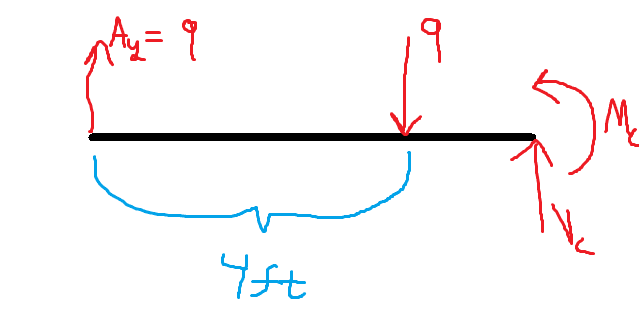

I skipped a couple of steps because I have the solutions manual - I know that my Ay and By are correct. That's why I ignored showing you how I got to them.
But here's the FBD that I used.
The question is how exactly they got a force of 3kip at 4 ft.
If I take the W=3x equation, then on 6 ft of the beam I get W=.5*6*3=9kip load. By centroids I know that it will act 2/3 from the origin so at 4 ft.

First things first. On the diagram in the OP, point C is located at 6 feet from point A, so you have to calculate the load on the beam between x = 0 ft. and x = 6 ft. You know that the distributed load has a magnitude of 3 kip/ft when x = 18 ft. and zero at point A. You can find out what w is at x = 6 feet by using a simple ratio. The shear force at point C = RA - w[@x = 6] * 6 ft./2 kip. You (or somebody) have already calculated RA = 9 kip, so the shear force VC at x = 6 ft. is going to be something less than 9 kip. In other words, your calculations have omitted the loading on the beam between points A and C.
I didn't omit the loading... I said W=.5*6*3=9kip between A and C. I don't understand where the book gets V=3 from. That is what I need help with. The rest of this problem is easy. I'm confused on how the calculated the load of the 6ft section.
But the 3 kip/ft is the magnitude of the distributed load only at x = 18 ft. That's why you have to use a ratio to find out what the value of the distributed load is at x = 6 ft., and then calculate the total applied load between x = 0 and x = 6 feet.
If I may chip in here, the problem the OP has relates to his diagram in #10 which gives a point load of 9 instead of a triangularly distributed load. If he calculates the proportion of w at x=6, then the value of load from 0 to 6 will give a total load in that region, but it is misleading to describe that as a concentrated load (and particularly not the value of 9) when considering shear force and bending moment. Also, to be pedantic, one cannot have a shear force at a section. But you can have a shear force just to the right of A, and just to the right (or left) at C. This is one of those rare cases where it is helpful to recognise that the loading function is linearly varying. Therefore the shear force equation is second order, and the bending moment a third order expression.

The original beam had only a single distributed triangular load applied over its full length. The 9 kip concentrated load located at 4 feet from point A (as shown in Post #10) was the result of an incorrect analysis of the problem by the OP, and there is no discontinuity in the shear force curve for this particular beam.
