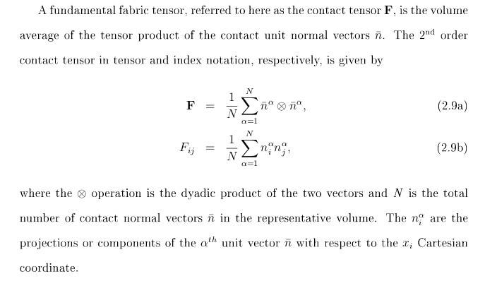

I can't read the paper since I'm not a member.
It surprised me how many articles are written about "fabric tensors". I hadn't heard of them before.
This thesis https://scholarworks.montana.edu/xm...2264/ShertzerR0811.pdf?sequence=1&isAllowed=y defines them on page 58 of the PDF , page 38 of the document. Perhaps some forum member who is an expert in tensors can explain them.
Likes AlekM
Wow I'm not sure how I missed that source, it is incredibly useful. Thanks for sharing!
I didn't realize that link wasn't open to everyone, for anyone else reading this thread here is a mirror: http://einsteiniumstudios.com/fabric_tensors.pdf
