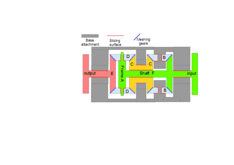

I've drawn my understanding of these gears.
I've simplified the ugly Frame A and shown how the D pinions are attached.
I've doubled up the pinions D and B because I don't like the asymmetric arrangement of the original. This simply provides balance to reduce bending moments on the shaft and to reduce vibration in operation. But you can remove one D and B if you want.
The shaft F is shorter than in the original: this was just an error which I couldn't be bothered to correct! It might be better to extend it to to seat in a loose bearing inside the output shaft, just to aid alignment of the two shafts? But with a cast base and the bearings for the shafts done in one through operation, I don't think it helps.
I have shown thrust faces on B but not elsewhere. I couldn't be bothered. The bearing for B is oversimplified, so it doesn't add anything anyway.
As someone else said, I can't see any use for this or any advantage over a simple 2:1 gear. But you never know. And it may be the principle is useful, even if the specific embodiment isn't?

This mechanism reminds me of a couple of automotive differential gears joined together. Shaft B transmits a torque into the mechanism which is rotated thru a couple of 90-degree turns and comes out shaft D (or vice-verse; it isn't clear from the one diagram). Or perhaps shafts B and D are both outputs and this mechanism permits a speed differential between the two.
Regardless of its usefulness, I give you full credit for your obvious improvement over the original design.
From the description it looks like an academic exercise. It is disproving the hypothesis that you can't double the speed with equal sized gears. It may very well be a terrible idea to do it that way but it is possible just the same.

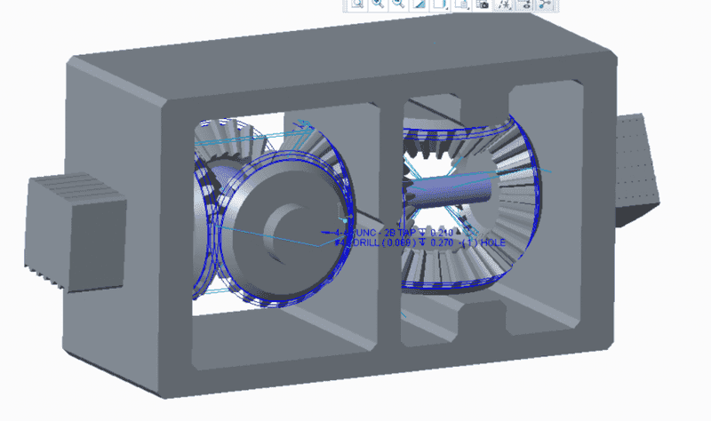

Well at long last the modelling is done. I'm new to mechanical assemblies and didn't realize just how involved and detailed you had to be when making things like caps and frames! Here is the model in Creo (my school's unfortunate program of choice):
The major outline of it comes directly from Merlin's sketch, so thank you so much! After that, it was all about measuring things and coming up with ways to connect all the pieces. Some used tapered "plugs" and others used a thread, depending on where I thought the most strain would come from. The handles are ugly squares with weird texture, just to make sure it wasn't too perfect. (ha). Thanks for all the help. It'll be sent away to the printer soon, I'll just be making sure the thing works together well in CAD first.
