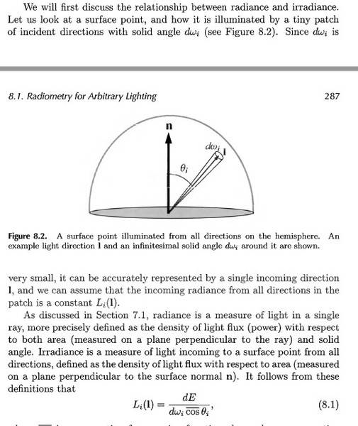

It's from the book Real-Time Rendering.
Does it help understanding why the cos(theta) is there?
Yes, that passage makes it clear that "irradiance" is measured per unit of surface area. There is a factor of cos(theta) ratio between incremental surface area and incremental subtended solid angle.
