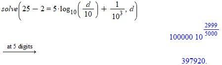

m - M = 5log_{10}(d/10 pc) + 10^{-3}
Hello, I'm struggling with this question
  • A star is observed close to the center of the Milky Way and from its spectrum we find that it is a type A3 star. Its observed magnitude is m_v = 25. There is only a diffusive gas between us and the star, so we can assume an extinction, of 1 magnitude per 1 kpc.
  • How far away is the star and what is its (un-redded) magnitude?
  • In the H-band, which is 1.63 , the reddening law is . How big is the reddening in the H-band?
I think I got the generel idea right for this problem, but I must be messing up my SI units somewhere. I use the distance formula when working with magnitudes and extinction. I look up the absolute magnitude for a type A3 star, which is roughly 2. I solve for d and end up with a distance of 398kpc, which doesn’t make sense, as the star is at the center of the Milky Way.
I use this formula and I divide A by 10^3 to get units of pc.
I hope someone can spot my mistake o_O
The last term should be d/1000, not 1/1000.
NSolve[25-2.0 == 5*Log10[d/10]+d/1000, d] gives d -> 8383. About 8 kpc.

Why should I multiply by d when considering the extinction term?
Mikkel said:
Thanks for your fast reply!
The extinction is 1 magnitude per kpc. So the farther away the star is, the more it's brightness is diminished. This is because you are looking through dust that absorbs the light from the star. The farther away the star is, the more dust is between you and the star, and the more light is absorbed. The way you had it, the extinction would be the same regardless of how far away the star is.
